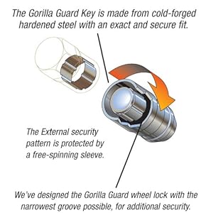

I just ran across a set of Mcguards locks that would be nearly impossible to defeat in a situation where someone was trying to steal your wheels. The outside of them spun on the nut, making the wheel lock remover tools useless. You would have had to either drill them which would take hours, or burn them off , in my case I would have destroyed the wheels. Thank goodness, the guy still had his original paper work , and I was able to obtain a replacement from Mcguard .

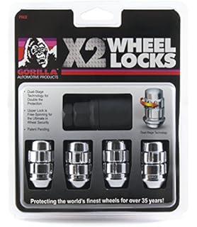

Originally Posted by UconnTim97 View Post
Thanks. Do you remember the model number or type of the Mcguard locks?
I think they are Gorilla, not McGuard.
Gorilla Automotive Products - Lug Nuts, Wheel Locks, Auto Security, Wheel Accessories
They seem to have a couple of different kinds. One of them has a free-spinning outer sleeve. The other kind has the "nut" (which looks like a spline drive) split into upper and lower halves, and I think the upper half is free spinning and the lower half is the part that you actually spin to remove the nuts.
