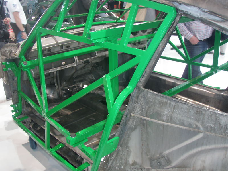

Old 03-31-2013, 06:16 PM
M Bryan's Avatar
Join Date: Apr 2013
Location: Crailsheim, Germany
Posts: 33
Taken at a Classic Auto show in Stuttgart last month

Old 04-10-2013, 08:14 PM
DIY wrencher
Join Date: Apr 2015
Location: Vienna
Posts: 228
Old thread but do you know which company was showing these Mark?
Does anybody else make them in the mean time?
