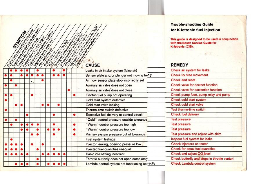

here is a little index to help to all of you.... if need it..
Ivan
This chart is for the older CIS cars and is not applicable to the OPs 86. Good reference for 83 and older though.

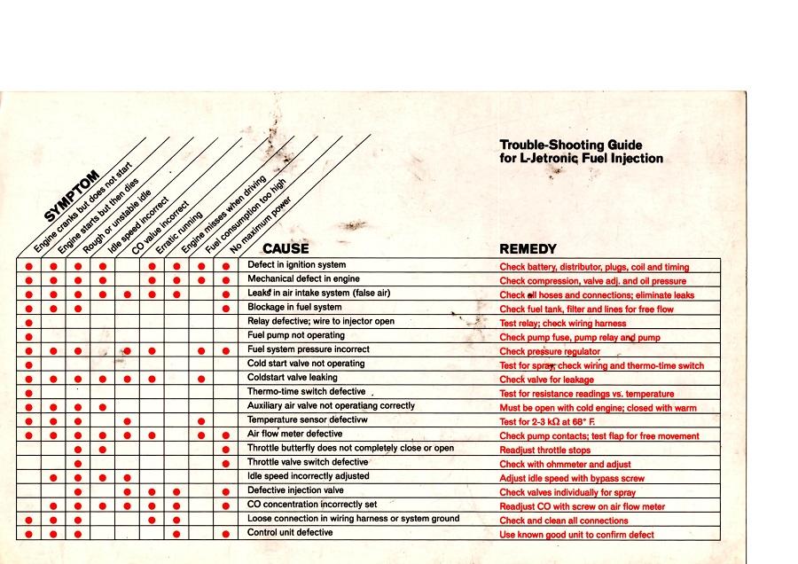

Location: Bohemia
Posts: 7,523
opss sorry .this is the one
Ivan
Ivan
Sorry Ivan, that came off a little harsh.
Edited: Still not ideal as the cold start and ignition system are different. The 86 is Motronic and doesn't have a cold start valve, thermotime switch...

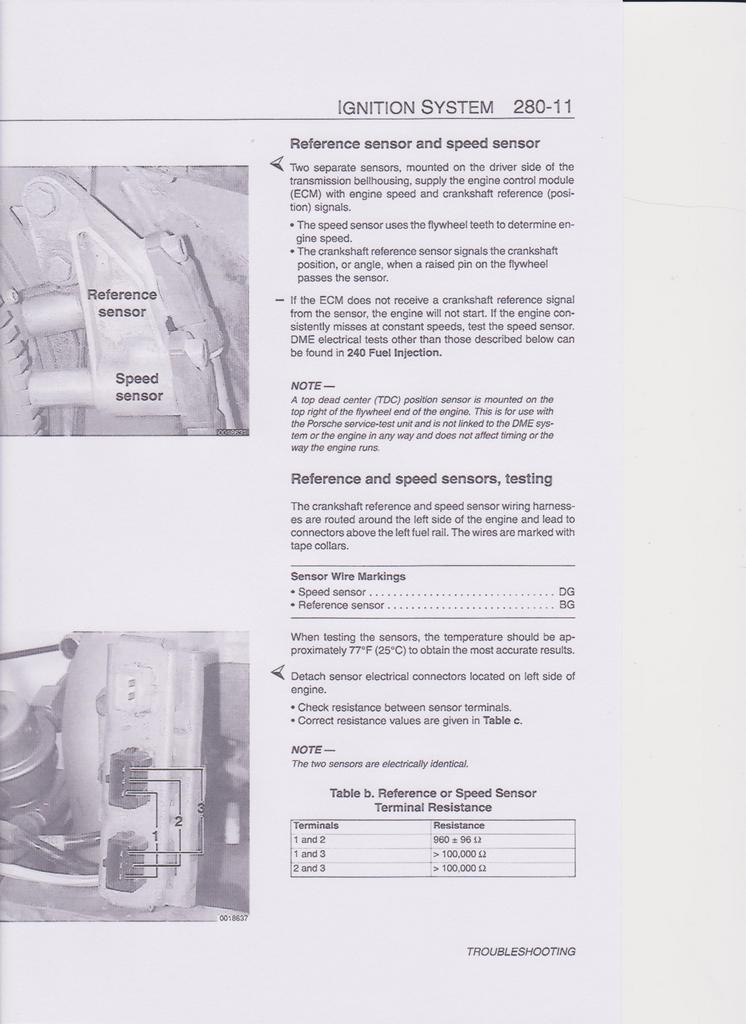

one more index for testing...
Old 09-15-2018, 12:00 AM
Join Date: Aug 2015
Posts: 2,752
This. Very common intermittent problem. If you test the resistance it may be within specs but still fail at times especially when hot. I would just go ahead and replace them.

If you end up needing to replace the Speed or Ref sensors, There is an interchangeable part from a BMW (still genuine Bosch) that has a slightly longer wire that is about 1/2 price compared to the Porsche one. i think the part number is 12-14-1-708-619-M14.
