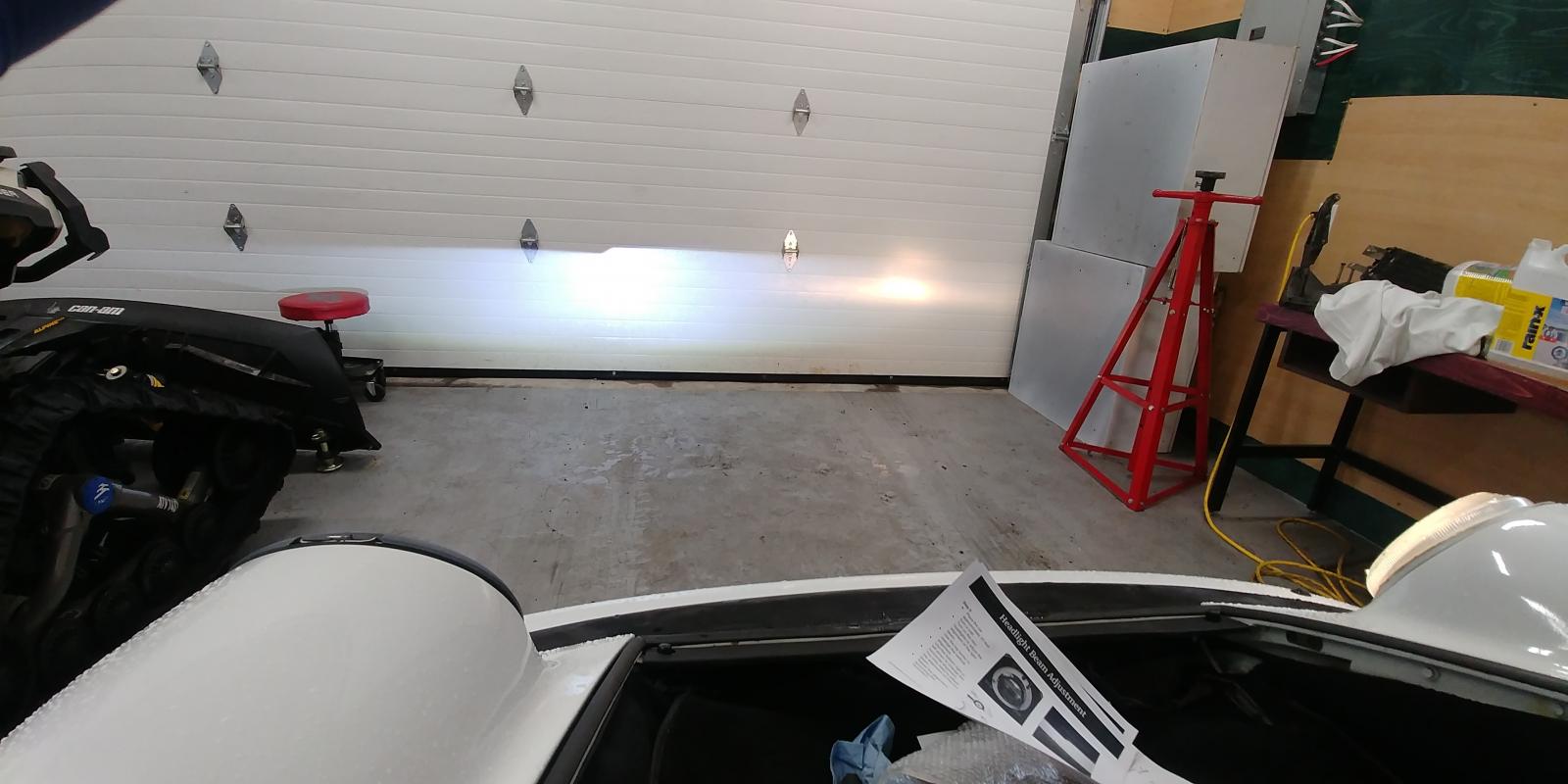

Can you speak more to the performance? Do they truly rival modern lighting tech? TIA.

I can say they are vastly superior to my stock H5s. They feel modern. Not the best picture but it's all I got
