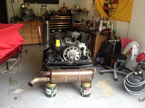

when finishing resent rebuild i found a 5L beer kegs are perfect to hold the engine strait..before installation;-)Best beer of the World can hold the best engines...
