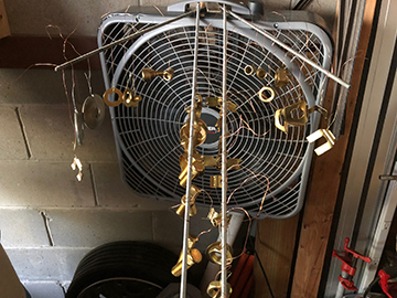

Thought I would add my recent experience with DIY plating. Shout out to Norm for his post on his process and setup...I used this as the basis for my plating setup. I have gotten very good results with the zinc plate and the yellow chromate - this weekend was my first attempt. I was not able to get the black chromate to work well so still trying to figure that out.
Here are some pictures of my setup, a stud with zinc and parts drying.
I really see the benefit of being able to plate parts on an individual basis as you need them.
Brook

Brook, NICE JOB! I love your setup, Especially your Porsche parts Xmas tree in front of the fan!
The tube I posted is part of the emergency brake. It inserts into the notch on the back-side of the rear trailing arm/hub assembly. The emergency brake cable runs through the tube feeding it into the hub where it passes through the 'flippy floppy things" (German technical term) that actuate the brake and is secured by the castle nut and cotter pin. Two tubes, one for each side.
