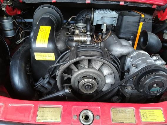

Here's what my 41k mile '88 fan looks like. I've owned this car since 1997 and been extremely careful in caring for it. I'm now at the point where the look of this is driving me nuts and I want to get it back to looking like it was when new.
None of the examples I've seen above reflect that reality, because the Zinc/CAD color is missing. Not sure how to get that back.

I used elbow-grease to get the cosmoline off the fan (brillo pad). I didn't like the way it looked shiny and showed scrub marks. So I did a test on the back using the soda blaster. It worked so well that I went all in. Fantastic. Protected with Gibbs.
The soda blaster didn't do squat against the staining on the housing. I had to go hard with elbow-grease and some 1000 grit sand paper. I'll be honest and admit I didn't clean up all the non-visible areas. I'm quite happy with the outcome as it still looks very 'factory' and not over-restored. I was careful to preserve the remaining CAD plating on the hub, although it's faded a bit with age.
