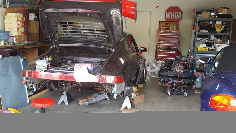

How about a couple of photos of ATV jack for engine drop . . . most ATV jacks are the same . . . we bolted plywood 2'x2' square to jack and in one photo you can see the 4" x 6" added to balance the engine . . . we always have some wood around to help . . .

Most ATV jacks have a fixed frame sticking up at the rear to support the mechanism. This can get in the way, especially if you leave the muffler attached.
There are ATV jacks that are like a wide floor jack and have no fixed frame sticking up. Like this:
ATV jack
More expensive, of course.
