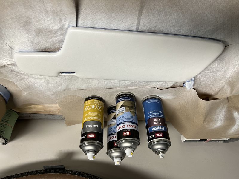

Whatever glue they used in the olden days was terrible and left stains in the vinyl headliner after a few years. Plus it was generally dingy looking.
So I decided to fix it with SEM Color Coat Mystic White. First you spray on SEM Prep, which is a pretty good vinyl cleaner and conditioner, the Color Coat, then optionally with SEM Tac Free if the final result is slightly sticky. Mine wasn't so I skipped that step.
Unfortunately the recommended Mystic White doesn't actually match the real Porsche colour. So much for Google searches. So I also did the visors.
In this case since I'd be handling them a lot, I did the Tac Free final step.
Came out excellent.

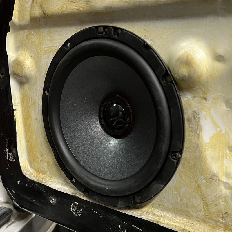

I also installed all the stereo equipment. Since I was replacing the door speakers, the panels had to come off. The window wires were so short just pulling the switch out disconnected them - no chance to take a picture for reference.
Door panel off.

Although everything I read said 6.5" speakers would fit, these ones didn't exactly sit flush. But I didn't butcher the doors anymore than the previous owner did with some small screw holes. I never like to make big modifications to cars just in case.
In contrast the deck speakers fit without issue.

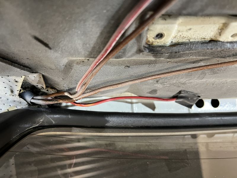

My rear defogger doesn't work and I suspect this is why. Anyone know where these wires should go?
