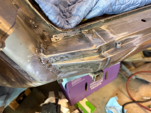

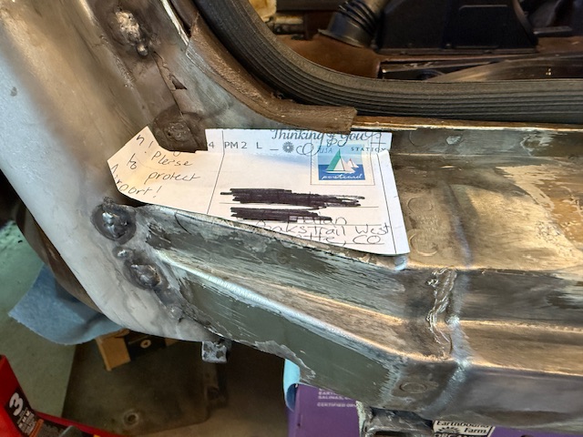

Finished repairing the rocker today. Nothing really to note, I think the photos tell the story. Next up is the door jam.

More photos. Didn’t get it quite right on the upper patch and had to deal with a gap. Worked out okay.

I “think” it’s going to work better to weld the quarter panel back together first and then work on the door jam. Only one way to find out…

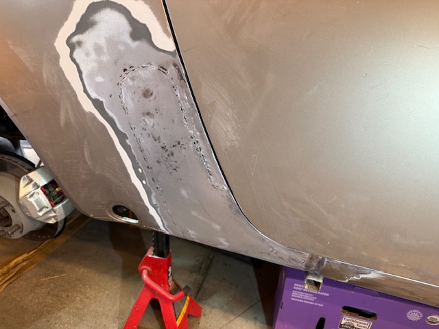

I tacked the fender in today. I cut out the rusted bottom section first. All rust in this area is removed at this point.
The scribe marks made before I cut it out were a huge help. I used strong magnets to hold things flush while tacking. It ended up fitting perfectly but not right away. It required tacking it in place in the right order and going really slow to keep from working my way into a dead end.
Still nervous to fully weld it in but making progress!

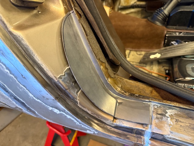

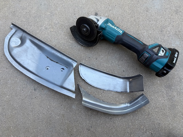

All tacked up! Photos below of the door sill work. Only used a tiny piece of the restoration design panel but it fit great and I’m so glad I didn’t have to fab something from scratch. it was worth the $100.

Last, I had to patch the rust on the lower edge of the fender. I ended up needing to cut a big section out to get to nice clean metal. Getting a perfect fit was a challenge and I just worked it slowly to keep from removing too much metal. It ended up with a really nice even gap.

And, here it is all tacked up looking like Frankenstein. Feels great to see it back together! Next up I need to do the final weld.

Welding in the door jam section with mixed results. Top and bottom of the weld is nice but the middle section sunk in about 2mm. I’m not sure what caused it, but it must be too much heat. My TIG torch was set at only 25 amps, but maybe I just went too slow.
I had hoped to avoid any filler, but I think I’ll just lead it in while I’m leading the rocker seam back up. Porsche used lead on many welds so it’s clearly tough to get the welded surface perfect.

Access is limited but I was able to knock the backside of the door jam welds and it’s nearly perfect now. Will still take a little lead but it’s looking great.
I welded in the main panel one tack at a time and that was a mistake. It still warped like crazy and I think a continuous weld would have worked better. It would have been much better if I had cut across into the wheel well. Two welds running my in parallel creates twice as many issues.
After planishing the welds and a bunch of hammering it’s looking pretty good except….
The patch is bulging out about 3mm. It’s a smooth and consistent curve but it shouldn’t be there. This is probably due to me hammering too much and stretching the metal. I’m now left scratching my head on how to get it to lay flat. I could try heat shrinking or using a shrinking disc but I’m not sure that will shrink it enough. Alternatively, I could run a weld down the center which shrink a lot and really pull the panel in.
I’m going to sit on it for a few days to make a plan.

To get the bulge to lay flat I ended up shrinking the metal with a torch. You heart a spot about the size of a dime to cherry red, hammer and dolly around the edge, then give it a few hammer and dolly hits right in the middle, lastly it gets quenched with water. It took about 10 spots to get it where it needed to be and to get all oil canning out. I used a contour gauge to continually check as the panel sucked in.
I also did a coupe of hours of hammer / slapper and dolly to get things flat. It’s far from perfect but it will only take a little lead to make things perfect. I’ll do a little more work on the panel and then call it a day.
In retrospect there’s a lot I would have done differently. For one, I think I could have done the whole repair through the door jam. If not, I should have just cut the quarter panel straight across to the wheel well. That would have cut the welding and warping in half.
