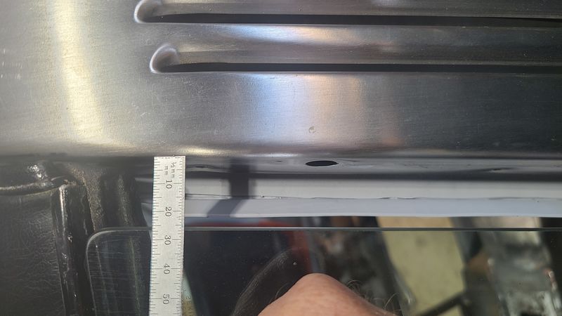

I was told that it is best to do some sanity checks, rather than strictly use the dimensions given in the repair manual for the Targa opening, since the car will flex some, but I'm a little concerned that the top isn't snug at all. All of the vital suspension measurements on the bottom of the car are good, so I don't really want to make any adjustments, but I also would like a second set of eyes on my sanity check measurements before I weld everything back up.
Since there's no rear quarter panels, rockers or front fenders to reference, I need to use the windshield and roll bar to check, but I don't see any specs to know what is reasonable. I got the door to be parallel at the the back of the window and at the front of the window frame.
Could someone with a Targa and a scale let me know if anything looks off? Or are there any good, very detailed reference photos that I should know about?
I have 25mm exactly from the back of the window to the roll bar and 9mm +/- 0.25mm from the windshield to the window frame on both sides. Seems like a good sign that it is symmetrical!
I'm leaving for Tokyo for 2 weeks on Sunday, so I have some good contemplation time if I need to figure out how to make some precise adjustments.

Between the 2 weeks in Japan (where I picked up a nasty flu), a few days of travel last week, house guests this weekend and travel next weekend for my mom's B-day, there isn't much garage time this month.
I did go ahead and weld up the laterals, since the doors at least have even, straight gaps and the roll bar to windshield gaps is exactly on spec. I also got the heat tube back in and did a first coat on the internal space. I'll use the hose and messy sprayer to coat again after all the welding is done.
My hole punch broke right as I was getting started on the inner fender panel, but the supplier got a replacement in mail right away.
This time I had to drill all the holes for the plug welds.
It does feel nice to have this back on. It goes a long way to make it kind of look like a car. I'm hoping to have the other side done by the time it warms up enough to paint outside again.
