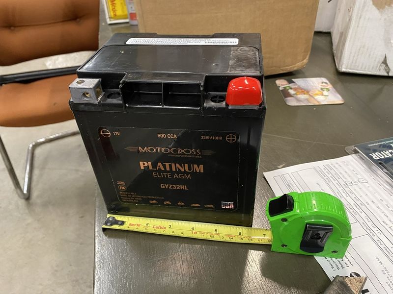

This little guy: https://www.batterymart.com/p-gyz32hl-yuasa-agm-powersports-battery.html
3 yr-old, sits on a modified Walmart cutting board with eBay hold down. Small, 6-1/2” long x 5” wide. Once in a while, he gets fed with a small battery tender. Never had an issue. 500 CCA
912E-3.2ss
