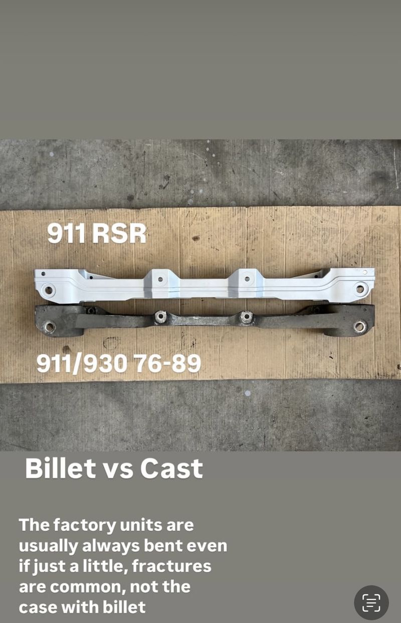

Saw this one being sold by Aircooled Exclusive on IG. Anyone have personal experience with one?

Looking at that "billet" piece as an engineer, I can't see how it "stiffens up the chassis." As a separate part, it's obviously stronger and stiffer (and heavier), but it still bolts to the body at only two points--at the ends. It holds the torsion bar ends and resists their torque with a 3-ft. long I-beam section. The amount of deflection of that cross member is minuscule relative to the body. The billet piece just makes it more minuscule.

I was looking at it more from the standpoint of the strength of the crossmember not really looking to “stiffen the chassis.” I have seen guys get cracks in the factory aluminum crossmember so I think this might be a better option to avoid that.

It depends on where the cracks are. I haven't seen cracked aluminum cross members (or steel ones either). Where do they crack?

Maybe it’s better for the aluminum crossmember to take the impact and crack rather than the chassis. I imagine it happens when hitting speed bumps, etc.
I would say about a third of the cars we work on have a piece broken off the crossmember. Many of them are slightly bent if you put a straightedge against them.
Aircooled executive seems to be effram’s /blackbird’s site. Is he selling billet cross members or just documenting the difference?
