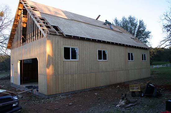

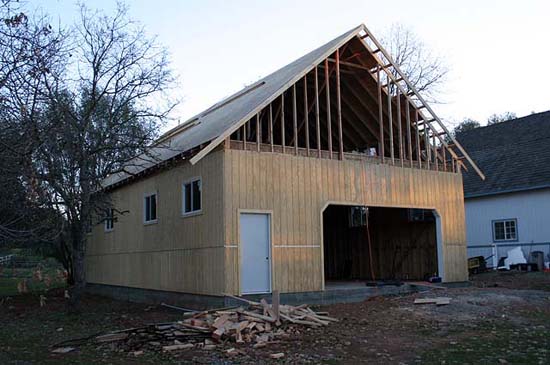

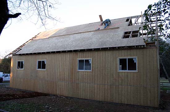

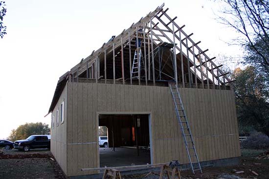

Its been a while since posting an update. Heres the latest as of today:
Shelby likes keeping Richard and crew company while their here.
A shot of the someday 2nd floor room/apartment.
Pretty nice view from the 2nd floor.
Roof should be on next week! I'll keep you posted.

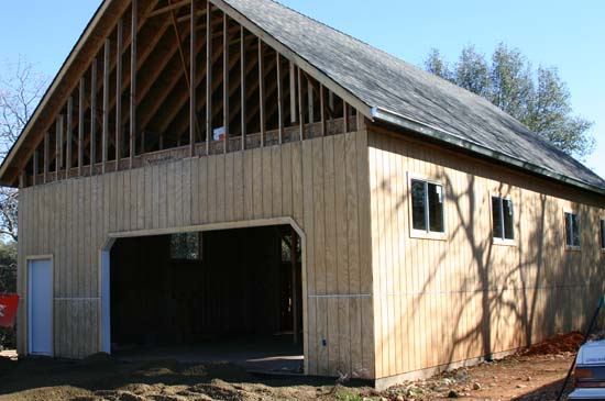

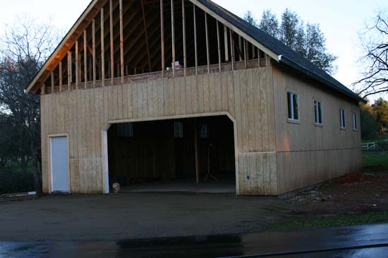

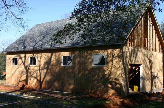

Update:
The rain has stopped and the roof and gutters have been finished. I’m really happy with the color and texture of it and it will probably be the roof we will put on the house when it needs to be replaced.
The siding has started to mold in some places from all the rain. We sprayed the areas with a bleach and water mixture and it appears to have taken care of the problem. Hopefully we can get some paint up before it comes back.

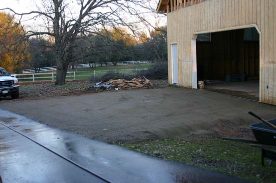

This is an image of the natural grade of the land in the front of the building. It slopes away and is about 12-15 inches lower than the entrance of the shop.
I had 25 tons of road base delivered last week to help fill in area. I had to bring some dirt from the back of the property and fill in the void in the front by the foundation and to the left of the shop so I could make the road base last and cover the whole area.

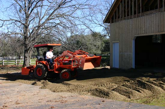

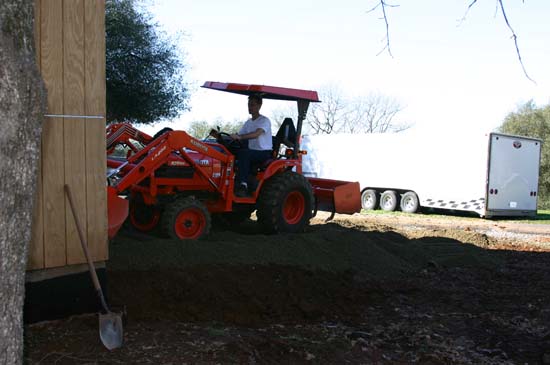

A shot of the parking area in front of the shop that has been fully graded with the Kubota and compacted with the F250 A huge thanks to Matt M for loaning us his brand new tractor. Man I want one of these… Who would think how much fun moving dirt would be.

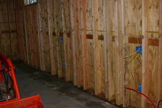

Ive started the electric and this is a shot of one of the walls. The layout will be the same on all the walls. Double gang plugs on top at 46 inches and single directly below, total of 6 sets on each long wall. The front half of the building will share two 20 amp circuits and the back half the same and everything is being wired in 12 gauge. The electrical work has proven to be fun and relaxing once I got the hang of it.
A big thanks to Richard for being willing to take my random calls on how to do certain tasks relating code and thanks to Scott Peterson for all his help pulling wire and installing boxes.
