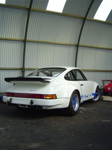

The only 3 liter sorta street car available in '74 from the factory was the Carrera 3.0RS, very rare very desireable
should look something like this

Yummy...simply yummy...
What I've found interesting about the 3.0 RS is it's listed as weighing 2,400 pounds. If true, that seems sort of heavy for the car...
It's still a beautiful example, though.

That is Yummy! I thought it listed at about 1900lbs. I was wondering how so low. Aaron I emailed you. Got more pics?

My '75 3.0RS/RSR replica:

Matt,
What did you use for the trim above the front bumper?

Looks like a 964 Turbo piece...

I think he used the IROC instead.

I don't think it's IROC trim:

Matt's car appears to have the more efficent and longer overhanging whale tail, also used on the IROC cars.
