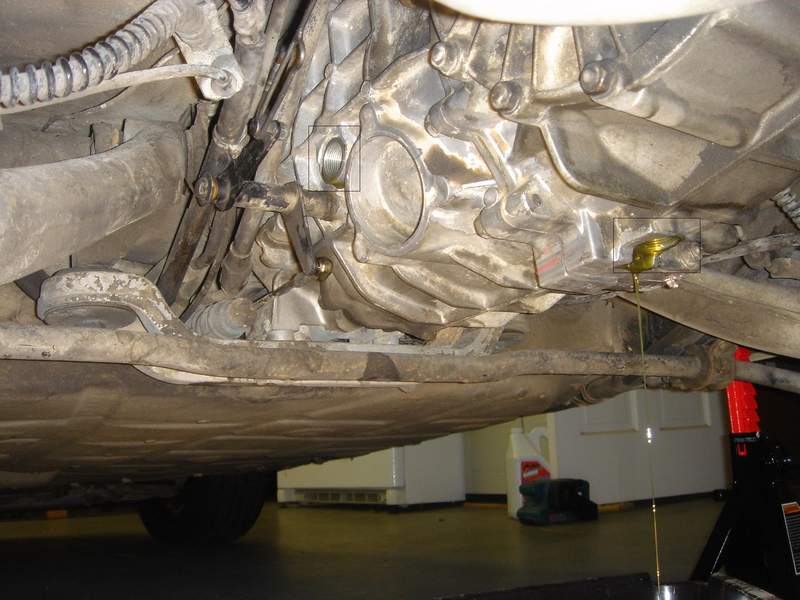

Completed gear oil change today with Valvoline 75W-90 Synthetic in hopes that cold shift performance will improve. Thought I would share some observations and pics. This was a very easy DIY project. Update 1-2-07: 36 degrees this AM in Atlanta - no cold shift problem!
With the rear end on jack stands and rear driver side wheel removed, I was surprised to find that the filler plug was not located higher on the tranny housing. In fact, when I removed the filler plug, approx 1/2 quart of oil came out. Immediately, I realized that the left side of the car would need to be jacked as high as possible on refill.
Working area under the car is very tight and leverage is difficult. I don't have a breaker bar or ratchet extensions for proper leverage, but a couple of taps on my ratchet handle with a rubber mallet worked well. After removing the filler plug (10MM hex) I then removed the magnetic drain plug and was happy to see that it was very clean . I then lowered the rear of the car and raised the front to drain as much of the old oil. An additional 1/2 quart came out by raising the front end.
To refill, I ran a length of 5/8" clear tubing through the wheel well into the filler hole. After filling with the first quart which went slow due to the lack of airflow, I cut the quart bottle in half and used it as a funnel and things went faster. Refill took a total of 3 and 3/4 quarts.

Filler plug location:
Filler on left, drain on right"

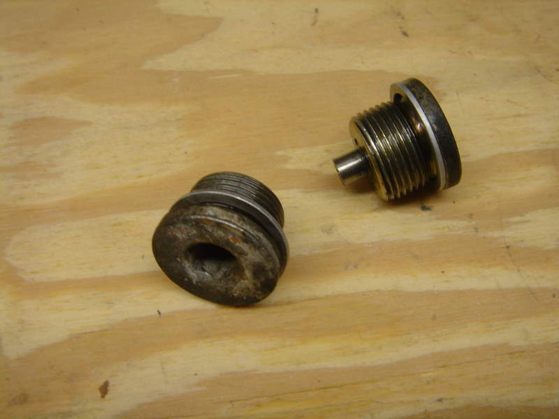

10MM Hex plugs - magnetic drain plug on right

3-3/4 quarts is a lot of oil to add. You're probably overfilled since the factory documentation lists "approximately" 3 liters of 75W90 API GL5 gear oil as the capacity.
1 liter = 1.056 quarts and therefore 3L = 3.168 qt. You're a little over a 1/2 quart overfilled.

I was thinking the same thing, Kevin. Not sure from reading the original post if the car was level when it was refilled or not, but it sounds like the left side was higher? Which, if it was filled to the bottom of the fill hole, would explain the overfilling. The car needs to be level left-right AND level front-rear. I found that by only lifting the rear, I was coming up 1/2 quart short on the refill. Raising the front to bring the car level allowed it to take the correct amount. The easy way to correct this would be to get the car raised and level, then remove the fill plug and let it drain to the bottom of the hole.

You might consider draining the excess to get the level correct, if it is indeed overfilled. Too much oil + high temps = potential leaks.
