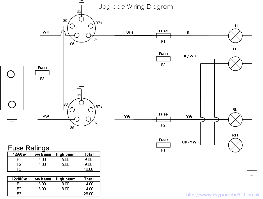

Hi,
I wonder if anybody happens to have a wiring diagram for installing headlight relays in the 911 ['85] to assist in protection of headlight switch. Don't like the fact that they run so warm figure that the extra protection couldn't hurt

Here's one i put together before I did the upgrade:
Pete
Pete,
You got overkill with fuses there. I would use just two addional fuses: one ea. 20 amp for the high beams; and 1 ea 20 amp for the low beams. Use all 14 or 12 ga wire and have it look something like this:
