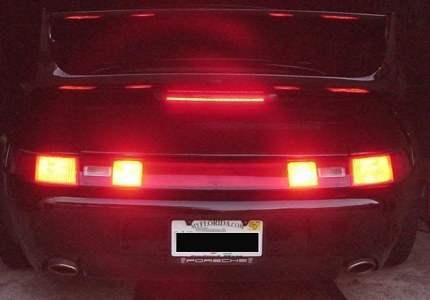

Fight fire with fire. My third brake lamp from the rear roof of a Denali SUV, mounted upside down on the tail:

Oh, not to worry. There ain't one part on my car that is original...CW's blood pressure rises whenever I show up.
