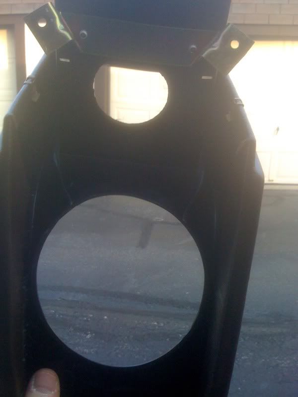

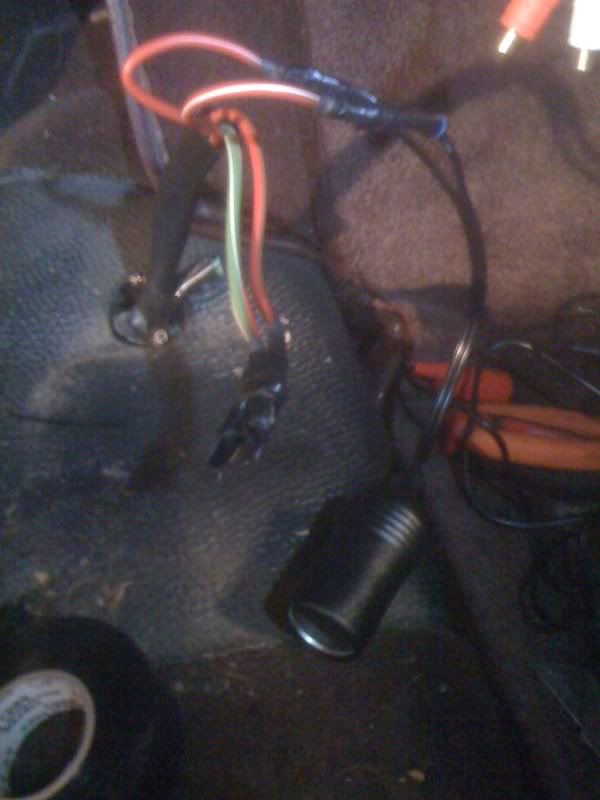

Posts: 4,306
using an ipod in place of a hu is easy to do. basically you need an amplifier to power your speakers (easy to mount under a seat) and then you plug the ipod into that via a patch cable. there are two downsides to this method. first you need a separate power cord for charging and second you have to find a 12v switched power supply to turn the amp on (or a constant supply with a toggle switch).
i searched around for something better and found one of these and have been very happy with the results (you still need a to make your own switched power line for the amp):
LiquidAUX™ Deluxe for iPhone and iPod - K33430US - Kensington
it works with any ipod/phone/touch (adjustable width and depth), charges them all, uses a line out instead of the headphone jack AND it comes with it's own remote. plus it is a clean, simple design. here are some pics of the installation in my center console:
tapped into the old ac controls for a power supply
cut a hole in the bottom of the console to mount it
used some velcro-like material to hold it in place
clean and simple install, easy to get to, all iphone functions can easily bee seen.
