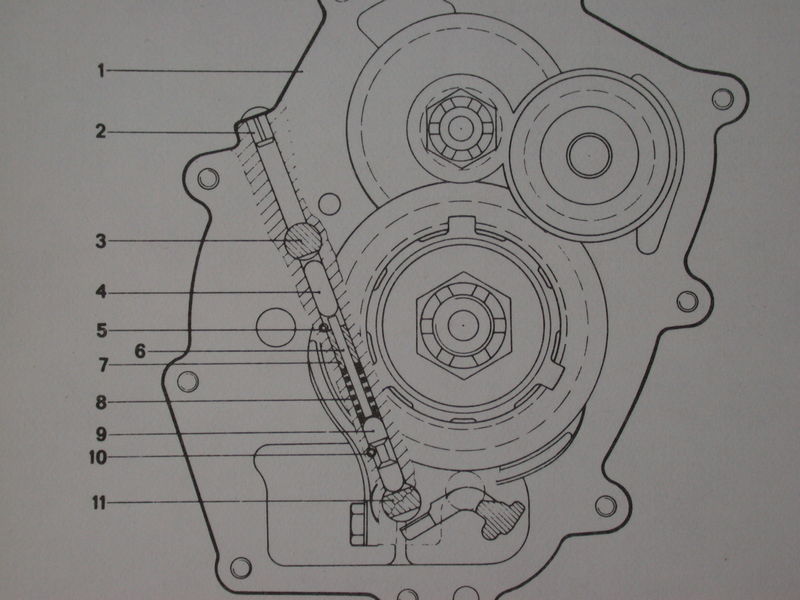

Looking at my rebuild photos, I don't see the switch pin. I don't think I put it in!! It didn't show up during the tear down either....hmmmm
Could this be the cause of the current situation?

If you can shift into 3rd or 4th while stuck in reverse, and the transmission locks up, then your midcase interlock/detent plunger (#4 below) fell out of position. It's now sitting above the 3rd/4th shift rod. It's very likely that you pulled two shift rods foward, but only one back into neutral, leaving the trans stuck in reverse...
Jon B.
Vista, CA

That's often a possibility as well, but in this case he did test drive the car before it became stuck in reverse. There may be other issues involved as well. By the way, if you're stuck in reverse, the reverse light should be activated with ignition on. If so, the rollpin is in place, but has nothing to do with shifting.
Jon B.

Do you suggest I disassemble the tranny and check the mid-case detent plunger? I remember working with the mid- case a couple of times during assembly due to the plunger slipping out. Could the plunger slipped out due the original mis-aligned shifter?
Thanks...Dan

If you can shift into 3rd or 4th while stuck in reverse, and the transmission locks up, then the plunger is absolutely out of position. It can only happen during assembly. In your photo above, the transmission is being assembled upside down, but it can occur anytime the midcase is handled. Yes, it's a good idea to correct the situation. The original poster to this thread just admitted he's still having issues. While the shift lever tower normally makes it difficult to engage two gears at once, it's a risk I wouldn't take myself. In the meantime, if you want to pop it back into neutral, follow the advice on page one, but realize it's a temporary fix.

when the trans is out of the car, remove the two tap-in plugs, one on top of the diff housing and one on top of the center housing and see if you can fish a detent out of the hole(s) with a pencil magnet. if so, you have a problem.

I pulled the engine and tranny today. I've got the nose cone off right now and I have no reverse switch pin! Not a clue what happened to it?? Does anyone have the specs' for this pin so I can fabricate one as I see they are NLA?
I pulled the plugs and fished out a plunger from the hole closest to the nose cone (front of car). Nothing from the other hole. I haven't removed the mid-case yet. Can I fix the plunger without disassembling the mid-case?

This is exactly what I said had happened, the plunger fell out of position and was sitting above the 3rd/4th shift rod. No, it cannot be put back in place without pulling the midcase. This was probably Andrew's problem as well, it's a common reason why 915's find themselves "stuck in reverse".

I removed the mid case housing. As determined yesterday, short detent plunger is on the outer part of the shift rod.
Next step...place the short detent plunger on the inside of the 3/4 shift rod hole on the mid case housing and reassemble??
What configuration should the gears and shift rod be in for reassembly (i.e. neutral)?
BTW, the shift rod tightening bolts were never loosened, so I'm assuming that they don't need any additional adjustment.

normally, you would slide a jig over the two roller bearings and shift rods and then eyeball the shift sleeves to be sure they are centered between their opposing gears. after the jig is on, slide on the 5th gear inner race and the big hub after that and snug the nut to pull everything toether. then adjust. so do your best with that. the notches in the two shift rods need to be on the same plane and have a small clearance between them.

I just replaced the other small detent plunger and it dropped nicely into the correct position INSIDE the case housing. During assembly last time I was working on the tranny upside down and it must have positioned itself on the outside.

If you don't have the Porsche manuals, the top photo shows the adjustment between the 1st/2nd and 3rd/4th shift rods, roughly 2mm-3mm. As John says, make sure the forks center the sleeves between synchros. Shift one rod into gear, then make sure the other is locked out, so you'll know the rear plunger is in position. Put the rods in neutral when installing the midcase. Make sure the nuts holding the guide fork to the access plate, bottom photo, are secure.
