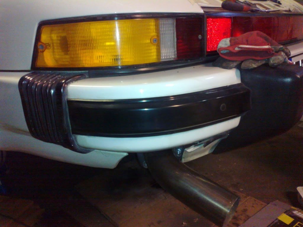

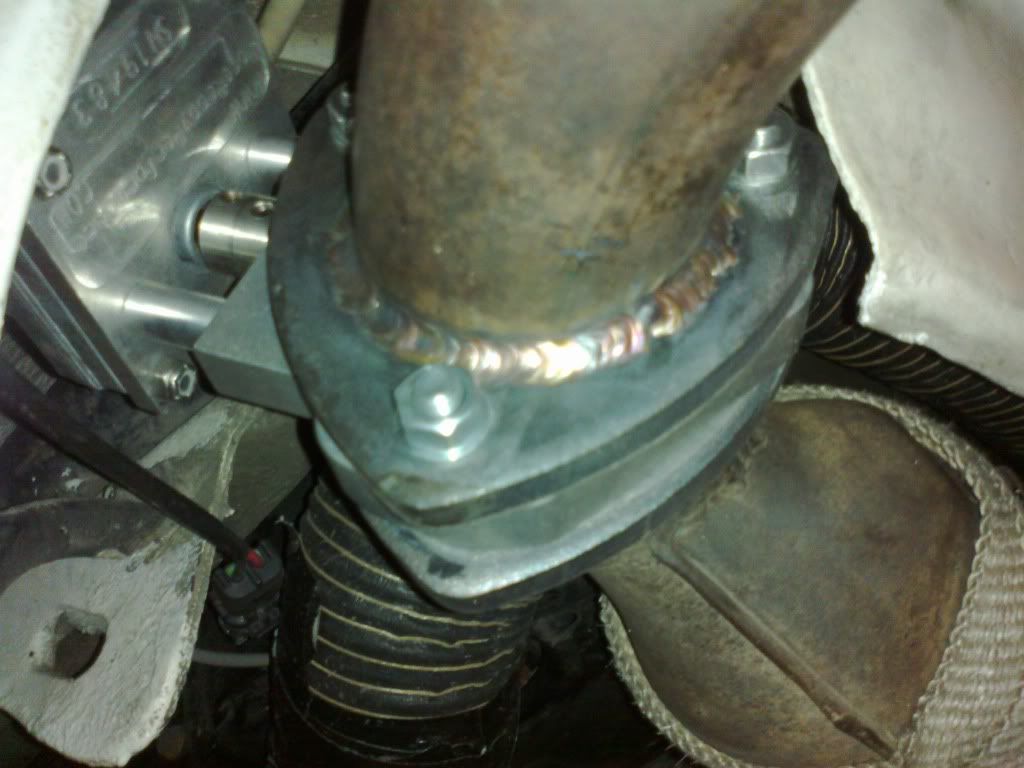

I have an elektric cut out on my 2-out system. It reduces the noice nicely when needed.
Installed:
Offcourse it cuts dow on the power a bit, but when just cruising it doesnt bother me that much. And with flick of the switch you have the full roar available
911-87 mit der 3.6 V-Ram und alles spaß

Jakas,
That is what I am looking to do! I figured someone in this creative group had done it.
It is, unfortunately, kind of hard to tell the mounting and dimensional details from the photos. Do you have a sketch or drawing with some basic dimensions available? I'm thinking that you made some measurements to get the pipe cut & welded.
What type of muffler did you start with, and what size valve are you using? My pipe appears to fall between the valves made for 3 and 3.5 inch pipe.

I have quite simple exhaust. Its basically 993 headers + 993 cat + 2x2,5" 90 degree SS angles
I used 2,5" valve from raceready performance. Allready broke one last summer, and the warranty did not cover for is.
I didn´t do any exact measurements. I just put the two flanges on the pipe to find the best spot for the valve. ( The fit is really thight as you see in the pics) Then i spot welded the flanges on the pipe, cut it and tested the fitment. When the fitment was ok, it was time for final welding.
