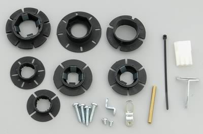

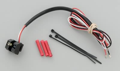

The Crane optical trigger is simple. It is an LED and a photodiode housed in a plastic part. The LED will illuminate the photodiode. A small trigger wheel interrupts the light path and provides the 12V "effective" square wave that will simulate the points opening.
http://static.summitracing.com/globa...715-0020_w.jpg
http://static.summitracing.com/globa...700-2231_w.jpg
I have had one in my targa for more than 10 years. No issues.
I even converted my SC distributor to one to trigger a Crane Ignition when I converted to twin plug and when the Bosch CDI crapped out on me.
If one needs to adjust timing on the trigger wheel it takes a flat file inside the "window". first measure the timing offset at each individual cylinder. Then adjust all to the most "advanced". Now reset the timing correctly for the optimized trigger signal.
The reality is that I only had to clean up two slots due to leftover sprue flashing from the injection molding process.
