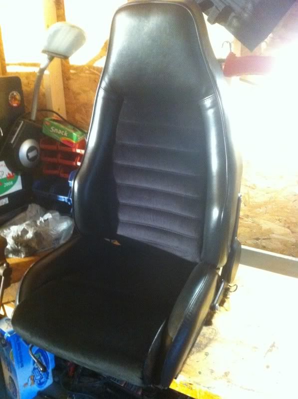

it has the correct sport seats. that style ended in 80 (or was it 81, i forget). i have a pair waiting to be installed in the spring.
Smoke
1982 911SC Rosewood
SCWDP # 0097
Old 02-02-2012, 05:42 AM
nineball's Avatar
Join Date: Jun 2009
Location: ohio
Posts: 4,306
yep, 80. this is mine.

About the seats
Hi,
Very nice seats!
Where can I buy seats like that?
They will be great on my 79 Targa. Need to change the covers anyway.
Thanks
Yaron

i got my set at hershey last year.
