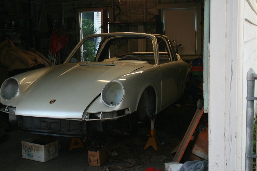

The car is an early-73 Targa that sat in a garage on jackstands for about 8 years prior to my purchasing it and from the history I have been able to put together, it has been in approximately the same state for the last 20+ years. I'm am hopeful to break the trend.
Here is a picture of it as it rested before I bought it:
The color is a pearl white that could only be found on an early-90s Lexus LS400. It actually is a decent 10 foot job but at the risk of offending any 1990 Lexus owners here, it is pretty ugly. I found the color code plate in a box and it suggests the car was originally Sepia Brown. The color inside the fenders and on various other hidden parts of the car support this. It has a period correct but a non-numbers matching 2.4T MFI motor out of a '72 donor. It is very dirty and hasn't been cranked in a long time but I am told it was dyno'd when removed and is supposed to only have some 40k odd miles. We'll see... I budgeted for a rebuild just in case.

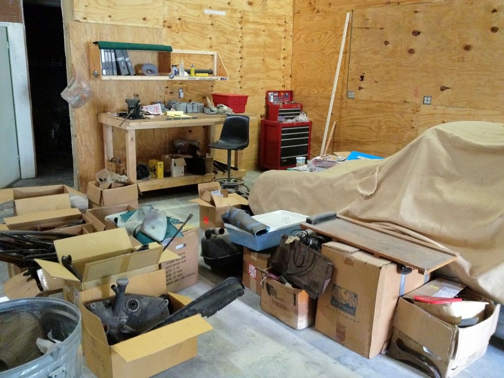

Here is a pic of the car moved to its new location, along with the boxes of parts that either go with it, or someone along the collected thinking they would go with it:
I'll end it here for now. Getting ready to head out to work on it. Since the above picture was taken, I have nearly completely stripped in preparation for body and paint work.

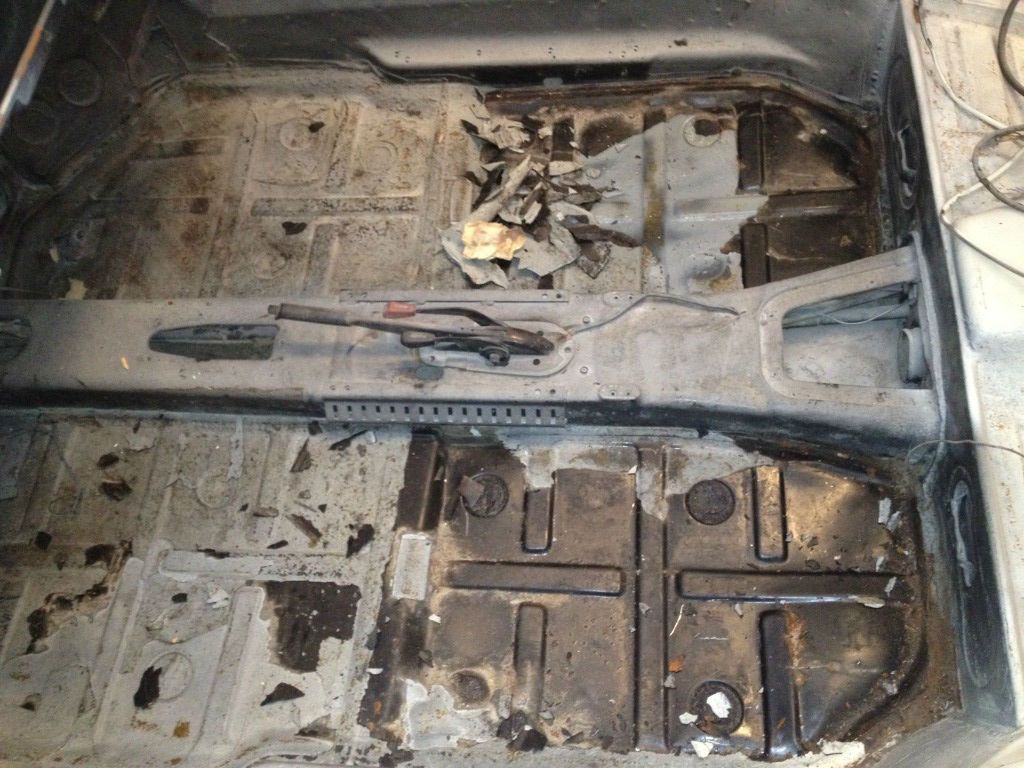

That is exactly what I am doing. Here is a picture I took yesterday showing the progress:
I went through all of the boxes and have catalogued the parts (not since yesterday but over the past few weeks). Stowed the boxes up on the loft in the workshop, cleaned my work area and began dismantling the remaining parts on the car.
This morning I was down to the wiring harness and cables. I have a spare wiring harness and really wanted to compare both side by side, pick the best and make any necessary repairs. That means I need to remove the existing one from the car. It looks like it should be straight forward but it felt like something was hanging up in the tube it runs through... so I stopped. Any recommendations? I'd leave it in place if it weren't as chewed up as it is.
Since I decided to stop working on that, I finished removing the sound deadening material from the floor. Yesterday, I got this far with just a scraper alone:
Today, I pulled out my new Harbor Freight cheapy heat gun... It worked fantastic and made quick work of the remaining!
A little surface rust but overall and in need of a little hammer and dolly work, but overall the floors are in really good shape.

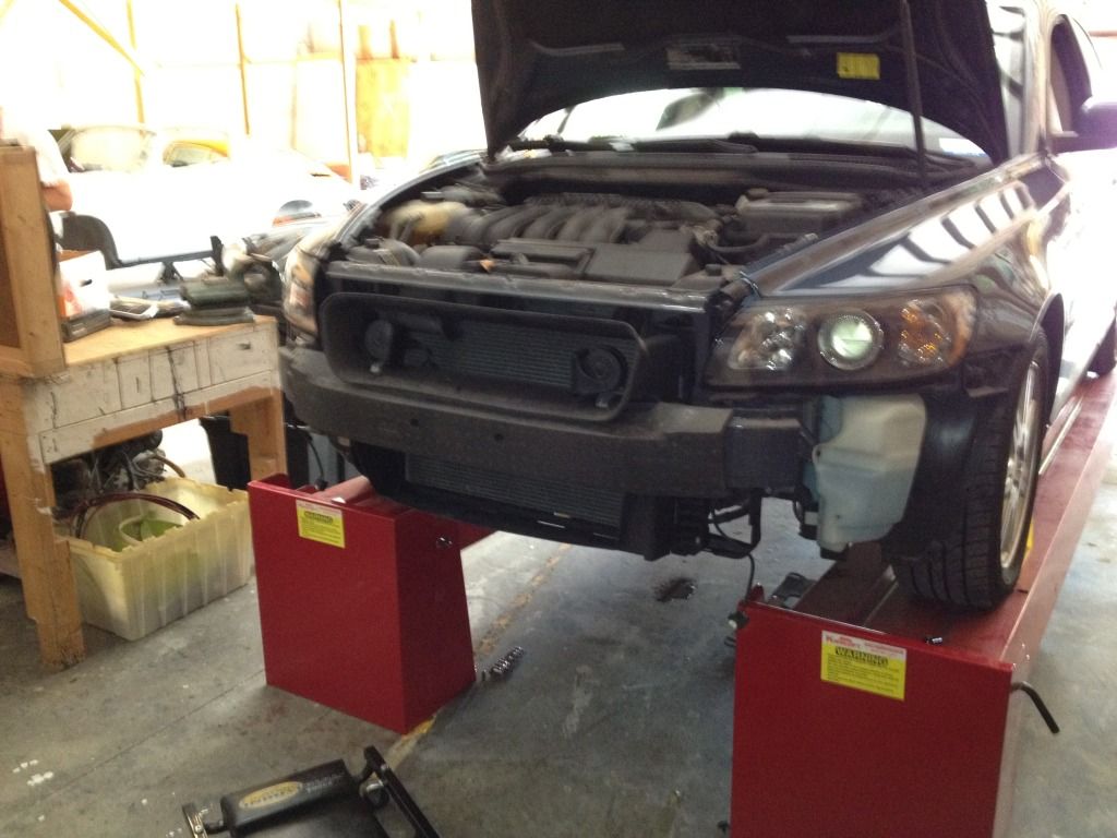

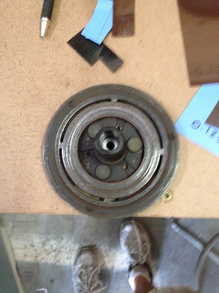

Today I am going to hi-jack my own thread for a post... I was hoping to check in today to report progress on the 911, but I spent yesterday working on my wife's Volvo. It had developed a condition where the air conditioning would intermittently cut out for 5 to 10 minutes at a time... this is bad in FL in August. Turns out the AC compressor clutch was worn and would not always engage when the car/ambient temperature was hot. Fortunately, it was adjustable by removing shims between the clutch and compressor. I did all the work with the compressor still in place and found that by removing the front bumper I had plenty of access to it. I took a picture and posted on my wife's FB page yesterday... more as a joke:
In this next pic, you can see the shims that space the clutch off of the compressor in the middle of the splined hole. By removing some of these, it is possible to bring the gap back into tolerance:
Finally, it fits back onto the compressor here:

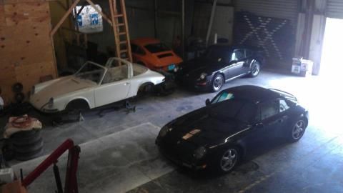

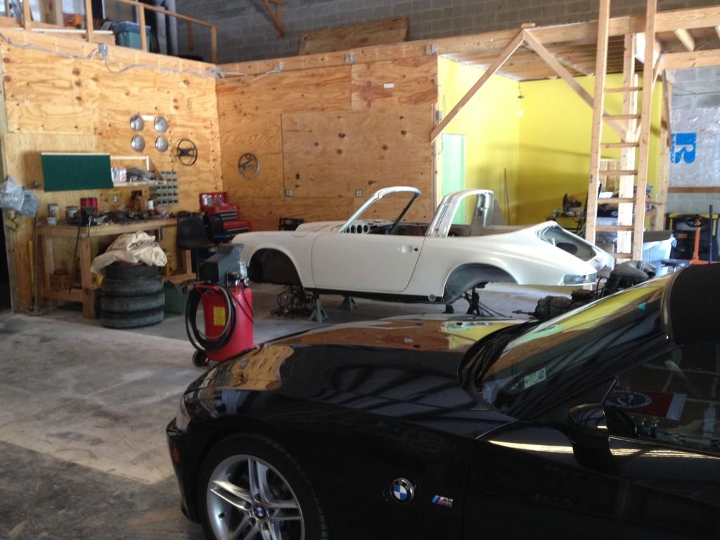

I still had a little time to work on the 911 when I finished but wound up kicking tires with my dad and brother, who along with fellow Pelican jbizzle78, share an industrial warehouse "mancave" we call the Gorilla Garage (after its former tenant). Here is a picture of the space taken by jbizzle78 the other day from the loft:
You can see my pearl white beauty in pretty much the same state as my posts from last weekend. The Signal Orange is a 71T and is owned, along with the 993 but jbizzle78. The black Carrera is my dad's, a recent acquisition through Pelican. It is an '89 3.2 w/G50 and is a pretty sweet ride.
I'll be back at my project this week. I'm down to (still) cables and wiring harness to remove from the inside. I have the harness to the point that it just needs to come out of the tunnel. Can anyone recommend the best way to do this? It appears to run through a metal tube inside of the tunnel and I was planning to attach a chase wire to it to ease with reassembly at a later date. I'm running into a problem in that is doesn't want to come out. I'm afraid there may be other leads branching of it that I have missed. Are there any components with electrical connections that attach in or near the tunnel? Finally, it looks like it should come out from the back end. Does this sound right? I checked the shop manual but didn't see instructions on the removal/installation of the wiring harness... but I may have missed it.
