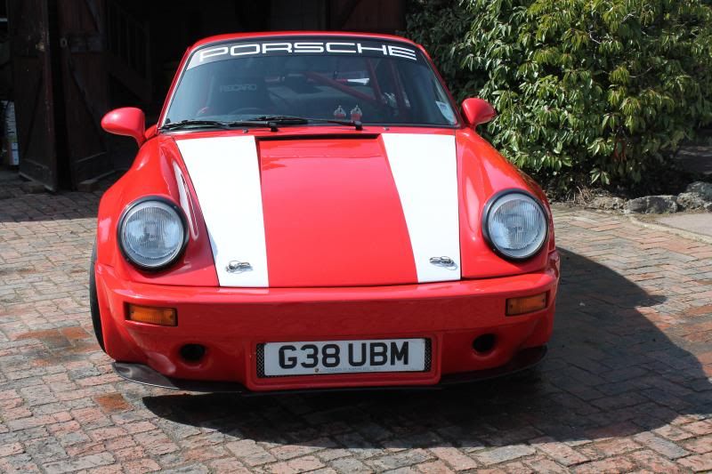

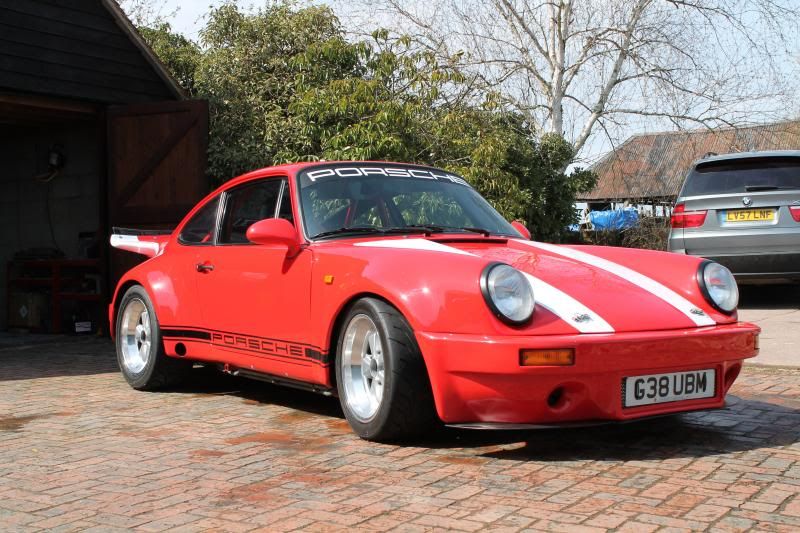

And here is the car, with Magnus approved red/white theme.
