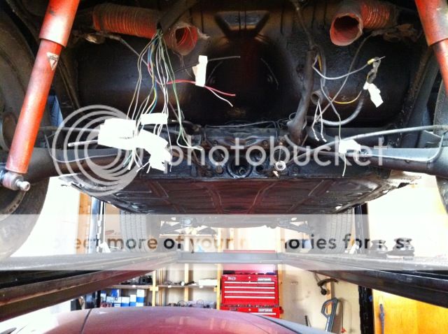

My '68 911 is being put together after having been apart for restoration, paint and modifications.
I do have a few questions I could not find answered in the forum. I checked the L57 and L59 wiring diagrams but with no success.
Background, the car had a slight enigne burn before I got it and I decided to make a 911R(eplica) our of it.
The po's had messed with the cabling but not that bad really, I think I have sorted out this and redone according to diagram L57 now.
I do have all the lamps and instruments hooked up and tested, wipers and light control ok, starter-relay cabling ok, charging system cables ok but engine is out so no testing yet
and plan to use the newer digital 6 MSD ignition as my resistor/resistor relay was burnt out.
Problem and extra cables

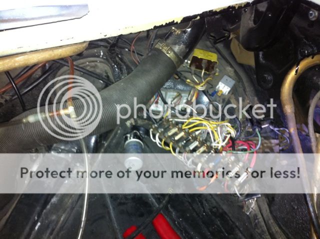

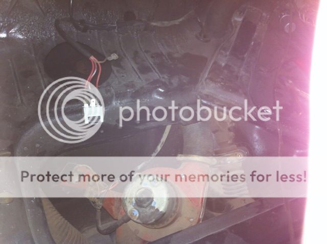

The relay close to the (smuggler box) fan is making alot of noise, had to unhook the earth to quiet it, I do find this relay in any diagrams, anyone familiar with this one?
Sorry for cellphone photos and garage dust.

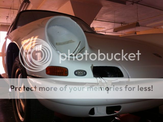

Not a big problem but fogs are not working yet, this must be the foglamp relay (yellow), correct? (the small extra relay may be aftermarket but it was not connected).

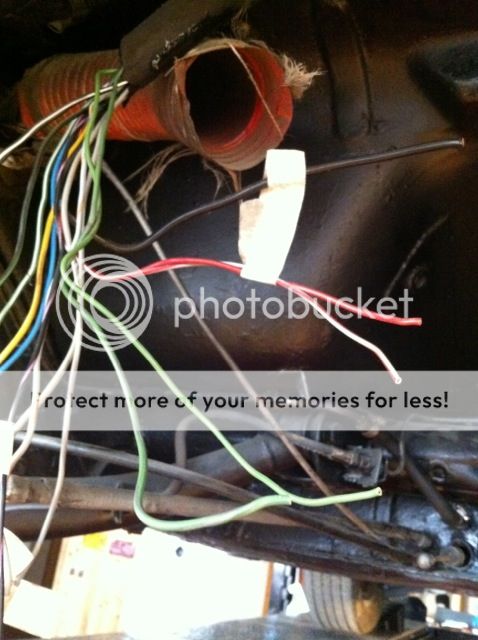

Two green cables from the tunnel, have no idea and my best guess is that they went to the heated rear screen?
Head, flash and parking lamps soon to be hooked up but wires are "live".
The car as it sits, not very far from being roadworthy.

I've the same additional fan in my smugglers box of my '68 912 and if I'm right, the relay is for driving the fan motor. The fan was an option, like the Webasto heater, and therefore not found in the wiring diagram. The relay is usiualy mounted under the dash, just behind the fan and fog light switches. The fan switch is also situated in that area. Check/replace the relay. The noise could be caused by a bad ground/earth or switch contact.
The yellow relay is indeed likely the fog light relay. The yellow relay is used to enable the fog lights to be switched on only when the low (or high) beam is switsched on. In many countries it is/was not allowed to drive with only fog lights on. They only where allowed to be used in combination with the H/L beam. Perhaps this is the reason why the fog lights did not function as you expected. So first turm the H/L on. The relay switches +12 V to the fuse box, where two green/white wires are used to feed the fog lights.
Looking at the picture the second relay is indeed not connected. It would be guessing what its pupose was. It is not a more or less standard mod/addition.
Regarding the green wires I would say: look at the other side of the tunnel and check where they end. Could it be that they are to be used for the oil level sender? At least one of them? Oil pressure and level are both green with a colored band.
I hope this helps a bit in solving your wiring problem.

Thanks, I am not sure if I will use the original fan but could perhaps keep that relay and hide away a smaller modern fan for "rainy days". I plan to use an Odyssey battery in the smugglers box. It struck me that one of the green cables in the rear must be for the oil tank level.
As of today my rear harness is cut before the original split, ... should it not split just around the upper mount around the left rear shock? Splits into the right rear lamp, the oil pressure and the oil tank into a separate loom from around that location? Not?

It has been awhile since I dealt with this relay, but here is what the factory relay looked like. I don't remember what it controls.

I am at work looking throught my photos and found another that shows where that relay is located. In the upper left you can see the wires for it.

I've made some picture and hope they will be a help to wire your fresh air blower. The wiring from my '68 912 has never been touched and the blower functions as it should.
The blower can operate at two different speeds. The switch in the dash therefore has three positions:
Pushed to the dash - OFF
Pulled to first "click" - LOW SPEED
Fully pulled - HIGH SPEED
The wiring of the back of the switch is shown below. Looking at the switch, a control light could be installed, but the wiring and fitting are not supplied. Perhaps someone (John?) could confirm the absence of the light and wiring:
Relay terminals:
85 and 86 - coil terminals
30 - mother contact
87a - connected to 30 when not activated
87 - connected to 30 when activated
The wiring of the relay:
Below the fresh air blower in the smugglers box and as a detail pic its terminal block:
