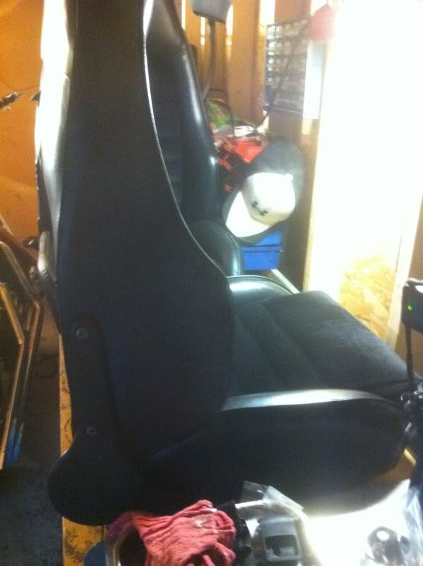

Could anyone with a trained eye give me a sense of what year these seats appear to be and what you think they're worth?
I'm also looking for a reasonable and high quality upholstery shop to redo the foam and install new leather covers and possibly porsche tartan inserts. I'd be much obliged for any recommendations and insight.

81-84, not sure on value

Incorrect. Those are earlier -- 74-78. Could be worth it for someone with a 911 in those years. Redone with corduroy insert would make them nice.

You sure Rookie? I thought 81-84 too...... Not an expert. Marko, you want to weigh in? Scott

Those look like my old -84 sport seats that I sold on this board 2 weeks ago. Mine were all leather. I got tons of interest very quickly after posting the for sale ad and got my asking price.

I am thinking 74-80 bolsters are more pronounced but I have been wrong before.

Lol.....I am having a set recovered right now and sadly I cannot tell you what the subtle differences are.
Rookie is correct they are worth considerably more if they are the older style.
I love the 80 - 84 Sport Seat for its light weight and comfort. Pelican Marko is recovering and repairing (foam) a pair for my Turbo Look in Can Can red leather w/black piping.They look amazing.

Thanks guys, for all of the replies. Still hoping that someone can confirm if they're indeed 78 - 80 or 81 - 84!

I think 80 - 84 look at the adjustor knob. The earlier ones have two levers, one with the Recaro logo The earlier seats have side supports

Smaller hinge and script fabric suggests '81-84.
Good chance they came out of a 944.
Sorry, no, you are incorrect.
Penguin... is right.
Those are absolutely 81-84 Sport Seats, NOT the early ones.
Absolutely, no question.
And the earlier seats were 74-80.
GTC would be spot on.. based on the fabric they would probably be from a 944. Although, they will surely fit the 911 as they are the same seat. 81-84

those look to be 81-84, attached are mine from an 84 944. I picked them up for $500 on the 944 parts page.
Autoberry looks to have the best deal on seat covers that look right.
