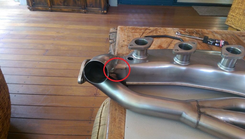

I'm in the middle of fitting SSI's to my 1979 911sc. They are thin flange.
The most painful parts seem to be over, but now the right side heat exchanger seam touches the valve cover, next to the heater inlet connection. This is preventing the exchanger from going up into position.
Has anyone else had an issue with this area?
Should I bend the seam to make it fit?
I have searched for similar issues or photos of this area and seem to be out of luck.
Thanks for your help.

About all you can do is bend it carefully. Never had issues with the originals.

The new SSI's I received some time ago did have a few interference issues. I had a problem similar to yours and had to dimple the shell to get things to clear the valve cover and had to rework the shell where it wanted to collide with the oil cooler. I also had to bend the seam done on one where the clutch linkage hit.

I will support them up there again today and see if I can bend the seam out of the way. If it looks like it will cause issues getting the valve cover off, they are being sent back.
They are the Dansk SSI type unfortunately. The fit kit even has 13mm nuts while the bent spanner they provide is 12mm. Its pretty disappointing given how expensive this whole exercise is.
After doing that I wonder how the muffler will fit.

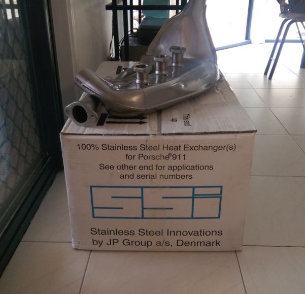

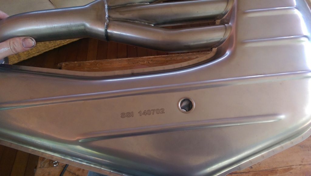

I believe that they are SSI from JP Group. They didn't come with the bags however.
Below are some photos of the box they came in, the underside marking and the problem area circled.

Did they come with any hardware for mounting?
Mine came in the box you have above, but with the bags, and the only hardware was the black special tool for the nuts (attacked to one of the bag pull straps). I wish I had a shot of the serial number. My SSI's are now out of my hands in a pro shop awaiting instillation.
I just realized that JP Goup is the new owner... so me having bags is not any indication that my SSI's might be new old stock.
