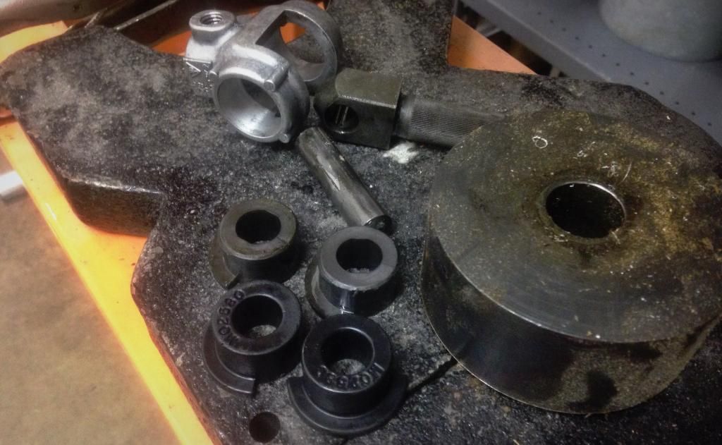

The car has been doing great!
I have been working on it a lot trying to get everything sorted, but still keeping it together enough to drive it and enjoy it.
So far this is what I've done:
Backdated the heat / deleted AC pump - to help make future maintenance easier
Rebuilt the chain tensioners with new collars and installed new cover gaskets
Cleaned as much as the gunk out of the engine bay walls/tins as I could
Replaced both the camshaft oil lines
Replaced all the small vacuum lines
Ignition full tune up - (plugs/wires/cap/rotor)
Adjusted the valves and installed new valve cover gaskets
Fresh oil change with some Brad Penn 20w50
Rebuilt the pedal box with the bronze bushings
Adjusted the clutch
Lubricated the door mechanisms
Installed aluminum door handles
Fixed & lubricated the heater/fresh air control wires in the dash (one was bent and inop)
Replaced all the dash light bulbs

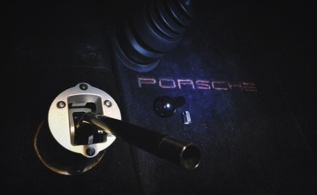

Installed a classic WEVO and new shift coupler bushings
Cleaned and lubricated the hood/trunk latch mechanisms and adjusted them
Removed the center console and put a patch of black vinyl over the remaining holes
Put new wiper blades on
Replaced the fan belt and adjusted it
I think that is most the big stuff, and the car is feeling/running MUCH better now. The shifter/clutch overhauls have made the car so much more drive-able I can hardly believe it. Also all the work on removing the heater motor and AC have made working on the engine a breeze, much easier to keep clean and see what is going on. The car idles smoother and I adjusted it to right around 900rpm which is significantly quieter than the 1200 it was at before.
I think next on the list are some steering improvements (turbo tie rods and a steering column bushing) to remove the spongy/squeaky nature that is up there right now.

Yes. It comes with new bushings for the front end of the shift rod too, which I think made more of a difference than the shifter itself as there was very noticeable play in them before hand. Now the shifter only has about 1/8" of play in any direction compared to the 1-2 inches of play before. I love the auto-centering of the WEVO though, makes it feel like a modern transmission rather than a 30-year-old one. I also HIGHLY recommend the shift coupler bushings as those made the biggest difference in drivability. The car is a breeze to drive now, even in traffic. I still need to do the trans oil but even without that I can't believe the transformation.

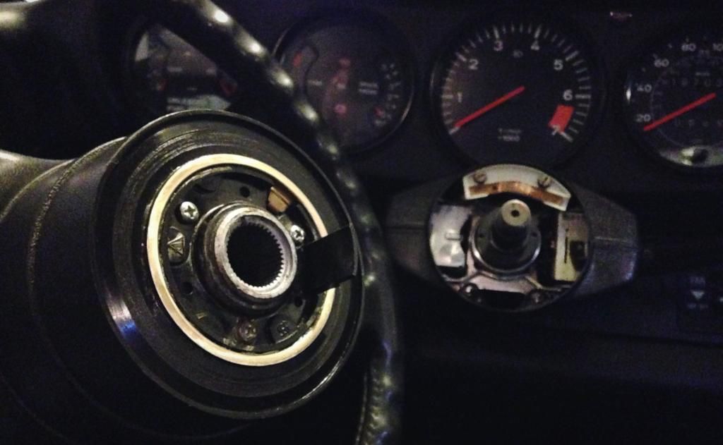

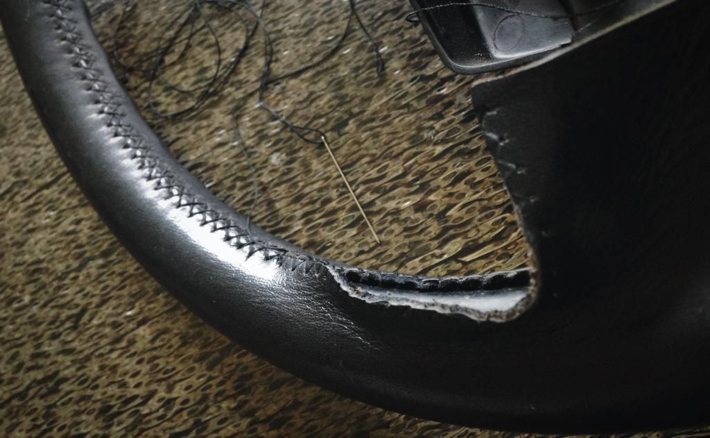

So I finally solved the scraping steering column noise. Turns out the contact ring for the horn circuit was rubbing wrong and had worn poorly. I block sanded the surface of the ring with 800, 1000, 1500, and 2000 grit sandpaper back to a nice smooth surface then lubricated everything with dielectric grease and now it is silent.
In the process I also purchased a Mitch Leland steering column bushing as I thought this might be the source of the noise (which it wasn't) but I do think it helped firm up the steering response and overall feeling so for $30 it was well worth the money. Apparently the PO's mechanic had installed a metal bushing that was starting to wear and had more play in it, so I removed that and installed the ML unit for an improved feel.
I also decided to re-stitch my steering wheel as the leather is in relatively good shape but the stitching had deteriorated and left most of the leather loose on the wheel. Took a LOT of time, partially because I was learning partially because it is just a slow process but I probably invested close to 8hrs into the project.

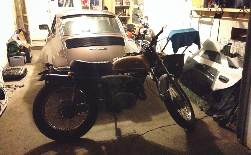

Now the car is resting peacefully in the garage with the motorcycles. Today was crazy nice weather in the PNW so it's bike season for the next while.

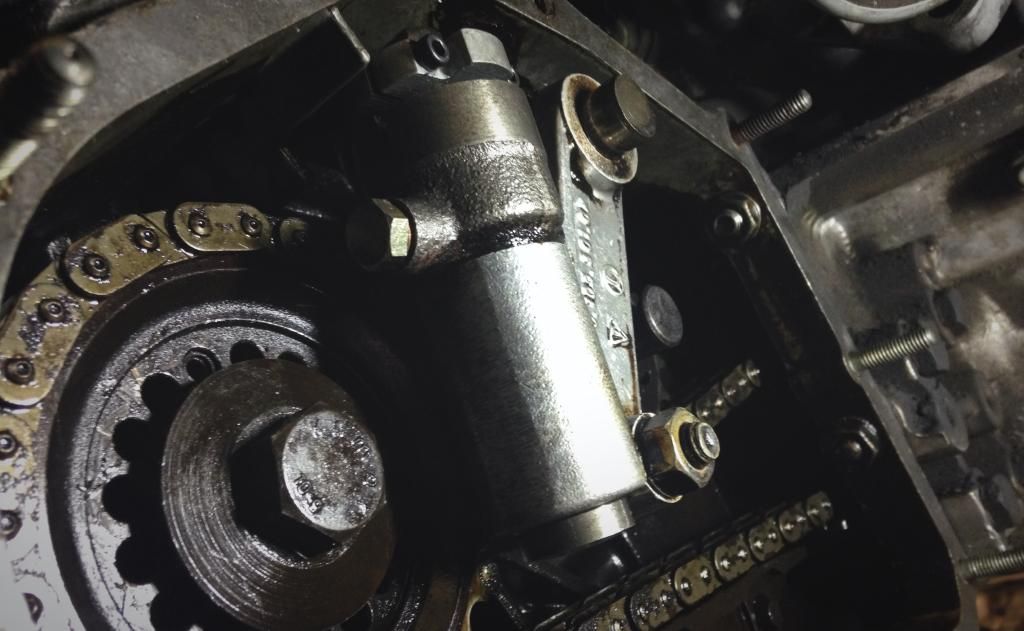

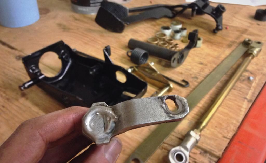

What's the chewed-up piece of metal in the first pic? Part of the old tensioner?

That chewed up piece of metal is actually the clutch pedal arm where it connects to the clutch cable in next to the pedal box. The clevis pin had worn through the stock plastic bushing and started eating away at the metal arm! I replaced the clevis pin and put a new brass bushing in there which seems to be working great now though I'm going to keep an eye on it to make sure it doesn't wear strangely. Ideally I'd have welded the arm solid and drilled a new hole but I don't have a welder right now.

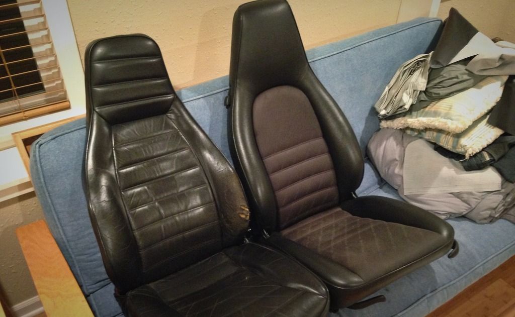

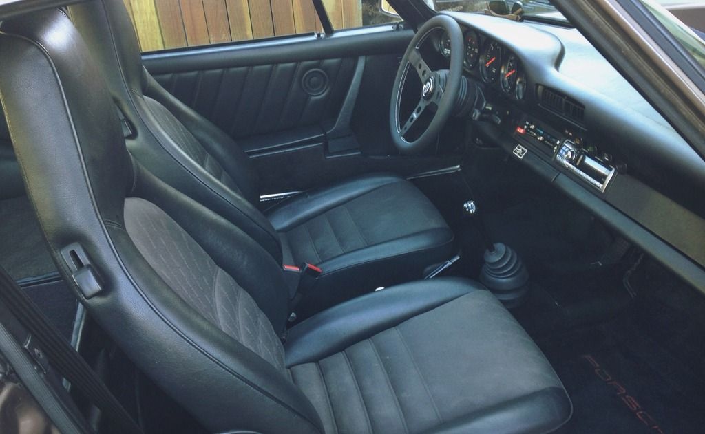

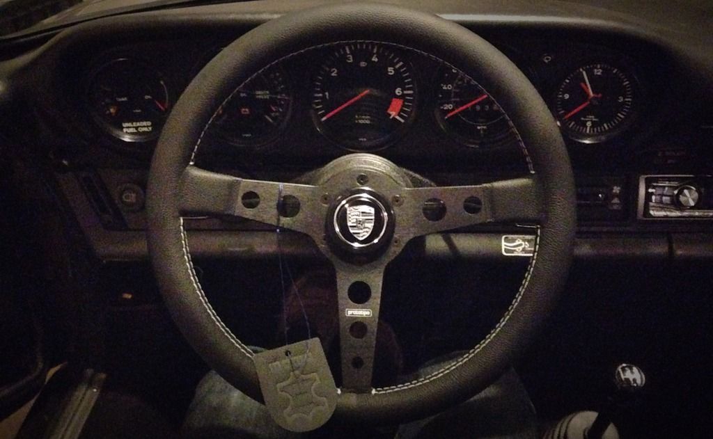

I bought a pair of seats off Craigslist a few weeks ago, I think they are 944 comfort seats? The seller wasn't super knowledgable about them and they were in a bit of disrepair but I took some time to get a vinyl repair kit to mend the tears and cleaned the fabric as best I could by hand. I think if I rent a steam cleaner I can get them looking even better but for the price I paid they are SO much better than the flat/abused stock seats and will last until I can get some nicer buckets.
Also, yesterday was my birthday and my fiancé showed her support of the car by getting me a brand new MOMO Prototipo with hub and Porsche horn button! Looks and feels way better than stock.
I got everything installed yesterday and we took it out for a birthday date-night. I'm loving the way the interior is instantly transformed to be more comfortable and functional, and looks better to boot.
