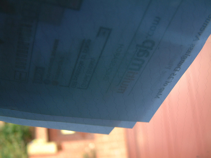

Glasgow 911SC's Avatar
Location: Glasgow, Scotland
Posts: 1,969
I have a heated windshield. Look closely through the glass & you should see very thin wavy lines going top to bottom. this pic is taken through my screen against a sheet of paper.
Hmm.Thats not very clear! Blinkin' compression!

There doesn't appear to be any imbedded wires for heating. Must be the standard windshield. It does have a single wire that goes around the outside about a half inch from the molding and then down the middle. I'm assuming this is an antenna lead?? If so, I wonder where the lead is. I'd like to connect it to my radio since I have ongoing power antenna issues. What do you think?

Posts: 3,445
With the windshield mounted antenna, there is a small FRAGILE wire at one bottom corner. You have to drill a small hole (ouch) to let the wire go into the front compartiment. Then you have to use an antenna amplifier.
If you have an antenna, you don't have a heated windshield. they are mutually exclusive. Also, all the heated windshields have the tinted top, now, the original untinted ones are NLA.
