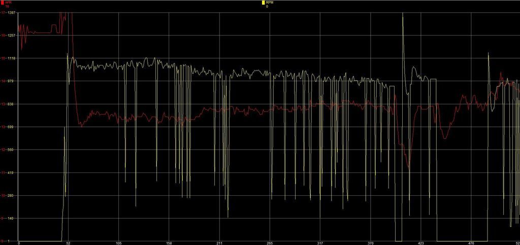

3.2L RPM / Tach Signal for Wideband Datalogging
I've been reading thru the archives but haven't found a solution to an issue I'm having with the RPM input for the 14point7 SLC PP2 unit. There's quite a bit of old material related to the Innovate products, but this product is relatively new to these boards and electrical isn't exactly my strong suit so I'm hoping someone can dumb things down for me...
I've tried tapping directly from the DME unit (pin 21), and directly off the tach (pin 2) and get similar results (screen shot below). I have confirmed the unit is configured with the correct multiplier. Wondering if this a ground issue, or a weak signal? Something else?
Any insight appreciated!
Andrew

I bought that same unit and haven't installed it yet, so I'm very interested in what you find. Just going from experience on another car I built a MS setup for, that looks like noise to me. I'd investigate grounds and connection quality first.

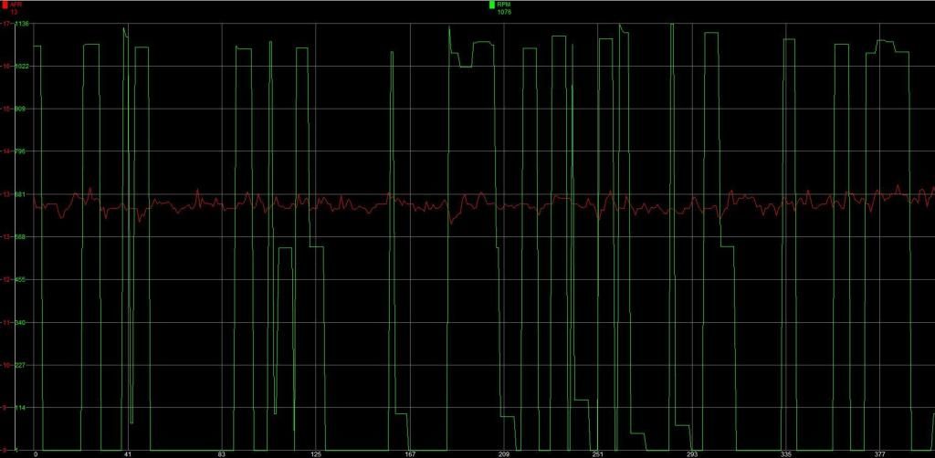

I'm reaching out again for help because 4+ months later and I'm still trying to get this working -
I'm fairly certain that I have a grounding issue. I've been trying to different ground locations and combinations and I'm getting closer, but I still get interference for any RPMs outside of idle. The instructions tell me to ground the system to the ECU and the lamba sensor to chassis or block. I'm getting the best result so far grounding lambda directly to the block.
Here's a quick log, you can see the RPMs zero out towards the end when I touched the throttle a couple times. Any ideas????

I should have updated this a few weeks back... Alan (the maker of the device) as a last ditch effort had me remove a tiny capacitor on the PCB labelled C19. I have no idea what it was for or why, but it worked and I had no issues picking up the RPM signal from pin21 on the DME which is the same as taking the single from the black/violet wire on the back of the tach. He said that once removed you would no longer have the option to pick up the signal from the low side of the coil or the injector ground. I had tried both these locations prior to the modification with no success either.
Unit works as expected now.
