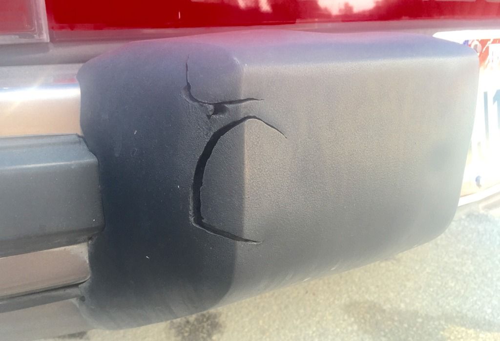

One of my bumperettes needs help. Was in the condition in the photos when I bought the car 12 years ago. Any repair tips? Of course I'm also considering just removing them as I do like that look. Thanks in advance.

use some masking tape to outline the cracks and fill with black rtv or your favorite sealer...

I would fill in the cracks with windshield urethane as it is incredibly strong and flexible, along with a screw to bring the loose ends back in. Fill the screw head in with the urethane then re-spray the bumperette with SEM bumper/trim paint.

They can be had on the used market fairly cheaply , got mine at Hershey for 80 bucks.
Just keep in mind Carrera ones and SC ones are different. the bolt pattern is slightly off.
