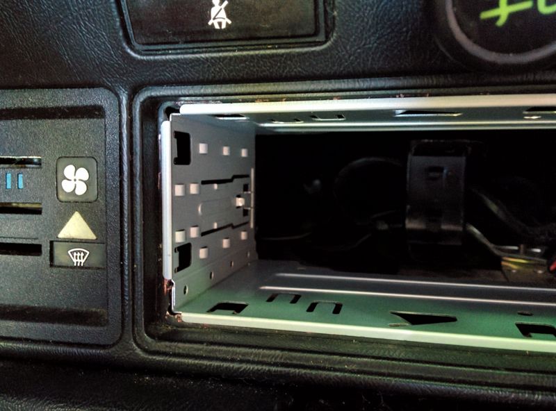

Once removed most of these have a sheetmetal "sleeve" around the opening in the dash that the radio seats into.
The sleeve is held in place with small tabs that bend to hold it in the opening. I unbent the old tabs on the existing sleeve from the old radio and removed it, then put the new one in and bent the tabs back to hold it in position.

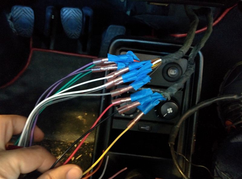

Affixed crimp terminals to the ends of all the new radio's wiring that would be used. There are a few unused connections shown on the manufacturer's diagram, which I left alone.
I then temporarily attached the terminals to the car wiring uncrimped, using blue painter's tape, just to be able to hook up the radio for a test run and be sure the connections mapped correctly.

One oddball thing - be sure to connect the (probably blue) wire for the antenna power booster, which is not part of the car side of this harness, but instead comes in with the antenna wire itself from under the glove box.
With all the wiring temporarily connected, I reconnected the battery and gave 'er a test run. Worked!
