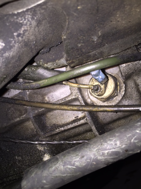

My speedometer still reads with sensor disconnected!?
I've been trying to diagnose my speedometer on my 930 for several weeks now (reading too slow, never going above ~60mph). In my attempt to diagnose the sensor that is attached to the side of the differential and the magnets and connections to the sensor, I disconnected the wires to the sensor on the differential completely and went for a ride. To my surprise the speedometer needle was still reading and moving and changing with speed of the car(although still reading incorrectly)! I was expecting the needle to not move at all, or be stuck at some constant speed. How can the speedometer be getting any kind of reading if the sensor is completely disconnected at the differential?

Originally Posted by fanaudical View Post
That's a weird one.
Did you disconnect the sensor wiring at the transmission/tunnel or did you disconnect it at the speedo?
Can you post a picture of current wiring to the speedo?
I disconnected the pins from the sensor at the transmission/diffy itself. My sensor is a little different in that the pins are connected right into the sensor rather than having a length of wire and separate connector. I don't have a picture of the sensor handy but it is the one on the side of the transmission/diffy with two wires connected via pins into the body. After removing the two wires I was expecting zero needle movement at the speedo and it is still reading like before. I would think it would either read zero, be stuck at some speed, or be bouncing wildly. It seems to read and goes up with speed, but not accurately.
Here are some pics of the wiring at the speedo. I have checked all the connections at the speedo and they are fine (removed and reattached).
The speedo readings were fine before, just a few months ago started showing slow speeds and maxing out at about 50-60 mph. I thought it was a sensor issue or the magnets that spin, but this reading with the sensor completely disconnected has me puzzled.

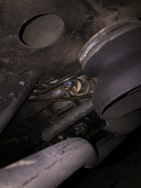

Old 01-01-2016, 09:22 PM
jwakil's Avatar
Join Date: Feb 2010
Location: Fort Collins, CO
Posts: 818
Ok, maybe I did disconnect the wrong thing. Here are a couple of pictures of what I disconnected (the white round thing with hex nut and two wires attached, the lower one is a white wire, and the upper which only shows the blue connector is a brown wire).
After searching some more, I found what I think might be the actual speedo sensor (below):

Old 01-02-2016, 11:01 AM
Banned
Location: Rockwall, Texas
Posts: 8,559
The first two photos are the switch for the reverse lights.
And yep, the last pic is the speedometer sensor. The wire connectors for it are inside the car, beneath the cover plate for the shiftrod coupler (in front of the rear seats).
