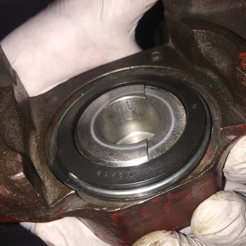

I got a FTE rebuild kit for my 86 Carrera for the rear calipers. The dust boot has the barbed metal ring on the inside of the rubber boot to attach to the caliper metal . They do not pop down over the ring. I tried prying clamping etc. Is there a trick to get these on? Is there an alternate source with a different attachment like the fronts that the metal ring snaps on over the rubber? In the meantime they are partially on and the calipers are installed but they are not doing there job of protecting the piston and bore of the caliper from getting moisture in and forcing another rebuild when they start to rust.
Any suggestions will be appreciated.

I just went through this on my car. Use needle nose plyers to crush down every third tab, that'll give you enough clearance to snap the ring down over the lip.

If the front caliper is like the back this is what I did. I cut a small piece of wood and carefully used a c clamp to clamp down one side of the retaining ring around the boot. Once the retaining ring is clamped down on once side you can then push down the other side. This thread helped me: http://forums.pelicanparts.com/porsche-911-technical-forum/341336-caliper-dust-boots-need-help.html

Another option for rear dust boots
So I ordered this from an on-line parts store I get my Japanese brake parts from.
The dust boots in this kit attach using the outside ring just like the Big Red ones pictured above and just like the regular front boots on my 87 Carrera. They seem fine, I did not photograph.
My FTE seals just installed on close inspection that I pressed on with my PVC pipe tool had been cut by the pressure of the tool. That finally broke the camels back and made me order these. I didn't change the piston seals inside, have read others says the Centric piston seal isn't optimal. I may place an order for the big red kit from their e-bay store for my parts shelf to try next. Our host should help us out and dump the FTE version.

Centric Dust Boot
Huh, looks the same height wise as the FTE to me, and maybe the Big Red but my pistons are a bit more extended. When this seal and the FTE are side by side, the only visible difference is that this one has an outward lip at the bottom for the ring. The inner which fits the piston is identical. I'm happy with the experiment, I'll keep something on the shelf which isn't the FTE going forward.
I think if you play some with the inner part, you could roll it inward and pull the seal lower. Just takes some patience in a tight place. I installed with the caliper off but its still a snug place to work.
