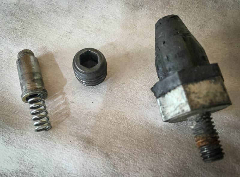

Question Identify these tiny parts...?
I took apart the interior of my '84 the other day, and found a few important-looking bits rolling around. Anyone recognize them? My first guess was some parts from my Wevo shifter, but I didn't notice anything external missing...
The last one was taken off of my air intake, and I believe it was screwed in there solely as a support for the aftermarket conical air filter. Probably just something the shop had lying around?

The middle one looks like half of the allen headed set screw for the shift linkage coupler to transmission linkage under the access panel in front of and between the rear seats.
The whole things looks like this;

The short allen-head plug also looks like it plugs the air injection port in the heads that have air injection.

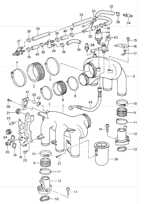

The rubber cone looks like the locating stud for the air filter housing.
Old 04-22-2017, 11:14 AM
Eng-o-neer
Tremelune's Avatar
Join Date: Dec 2011
Location: Los Angeles
Posts: 3,108
Yahtzee! 28 - Part number 993 110 321 03 - bonded rubber buffer

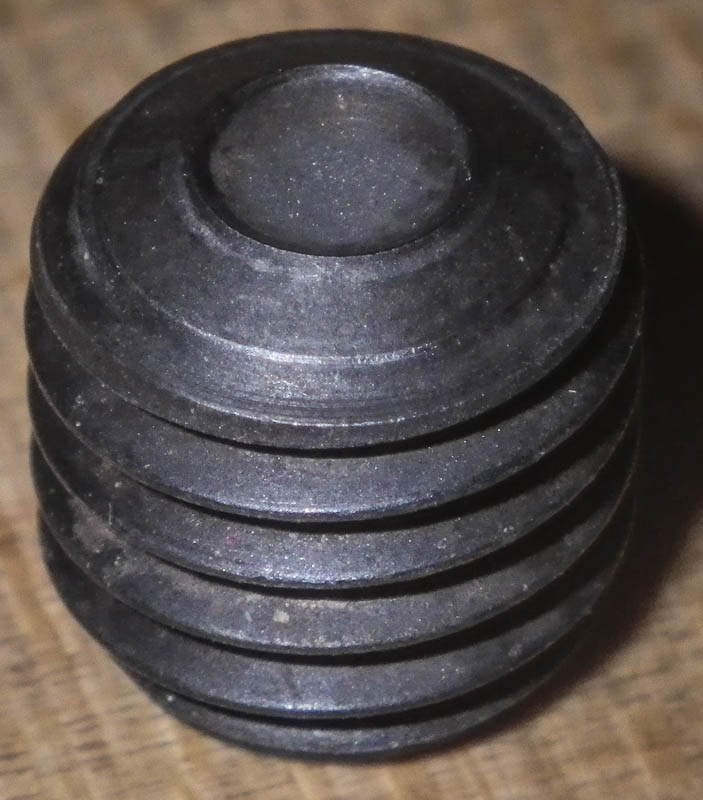

Got a close shot of the bottom of the hex screw...It doesn't seem to be sheered off, but it's hard to tell much of anything.

Fetzer Valve bearings and mounting bits.....

I think I solved the mystery...This would explain why my shifter got so rattly in the last week or two:
https://www.wevo.com/Products/ShifterProducts/ShifterImages/WEVO_915_Shifter_INSTRUCTIONS_2009.pdf
25 - LC 026B 09 M - WEVO PLUNGER COIL SPRING
26 - 48200 - M10 X 10 SOCKET SET SCREW
27 - XT_144 - WEVO PLUNGER BUTTON
