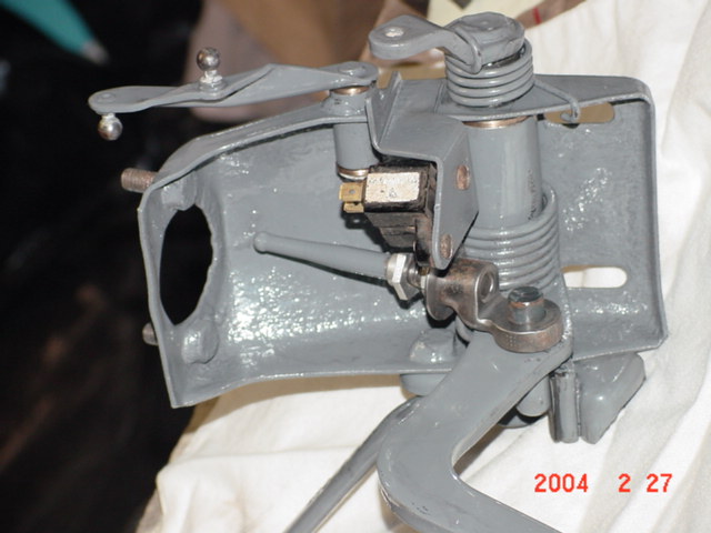

brake Job Run amuck
before
flesh heals, memories last forever!

grind weld build
sean_V8_914's Avatar
Location: San Diego
Posts: 1,251
During

grind weld build
Location: San Diego
Posts: 1,251
After.....

grind weld build
Location: San Diego
Posts: 1,251
Cool
...mmmmmmmmmmm, bronze silicate & graphite moly smoothy

Looks great Sean! Fun getting that rust off the pedal cluster isn't it?

almost as much fun as beating out the roll pin from teh clutch peddal

Why do you have all that stuff on your bed?

don't forget the arm on the brake light switch goes on the other side of the round piece.

Purdy. What you did is now on my list of things to do. THANKS ALOT!!
What sort of caliper paint did you you use? How did you clean and prep the caliper? Looks great Sean!

It figures, NAVY grey.....

Navy grey is POR 15
I boiled water, added Castrol de-greaser+dish soap, soaked about 1 hour or till water was about 140 deg f then hand scrubbed with a Scotch Bright pad. second wash was with isopropyl alcohol. Paint is epoxy Krylon with a clear coat of Dupont Urethane(impurvious to most chemicals)
thanks for the tip on teh brake switch

Heh... You learn pretty quick, because your brake lights will not go out. At all. That's when you say, "D'OH!" and frantically look for pictures of the pedal cluster in the manuals.
Uhhh, not that I know that from direct personal experience or anything...
