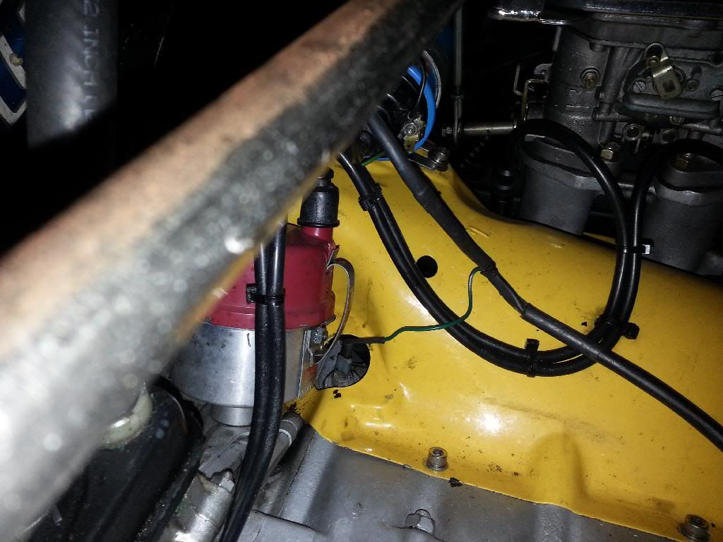

Here is a photo, maybe I am confused again but it looks to me like the CHT sensor wire is coming out of the ignition wiring harness... maybe I should call it the Ignition coil wiring harness after it splits away from the wiring that goes to the starter? And maybe I should be looking into the engine bay when I comment so as to not be going by vague memory too.

What you are showing, right there next to the ignition distributor, is the oil pressure switch, and that green wire goes from there to the oil pressure light in your instrument cluster. This photo shows a 914 cylinder head, and the empty hole near thew left (#3) spark plug is where the CHT sensor goes. With the head installed, this sensor is about 18" from the distributor. This is a CHT sensor:
Now we should be clear. The oil pressure wire does NOT need to be plugged in to run the engine, at least not on this car.

Yep, that clears it up. I don't have a CHT Sensor installed... and I should have known better since I have a brand new one still in it's packaging from MANY years ago that looks exactly like your photo.
So that rules out a CHT sensor issue.
