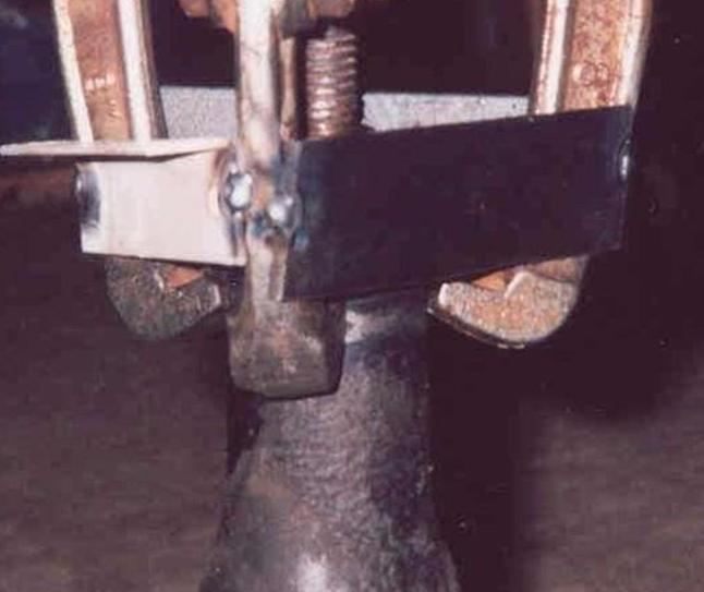

Old 03-02-2003, 12:54 PM
Join Date: Dec 2001
Location: Georgetown, MA
Posts: 137
I pressed the shaft out with a 3 jaw puller. First side worked great. Other side, jaws kept slipping off so I spot welded some scrap steel to hold in place..broke them off when I was done.
