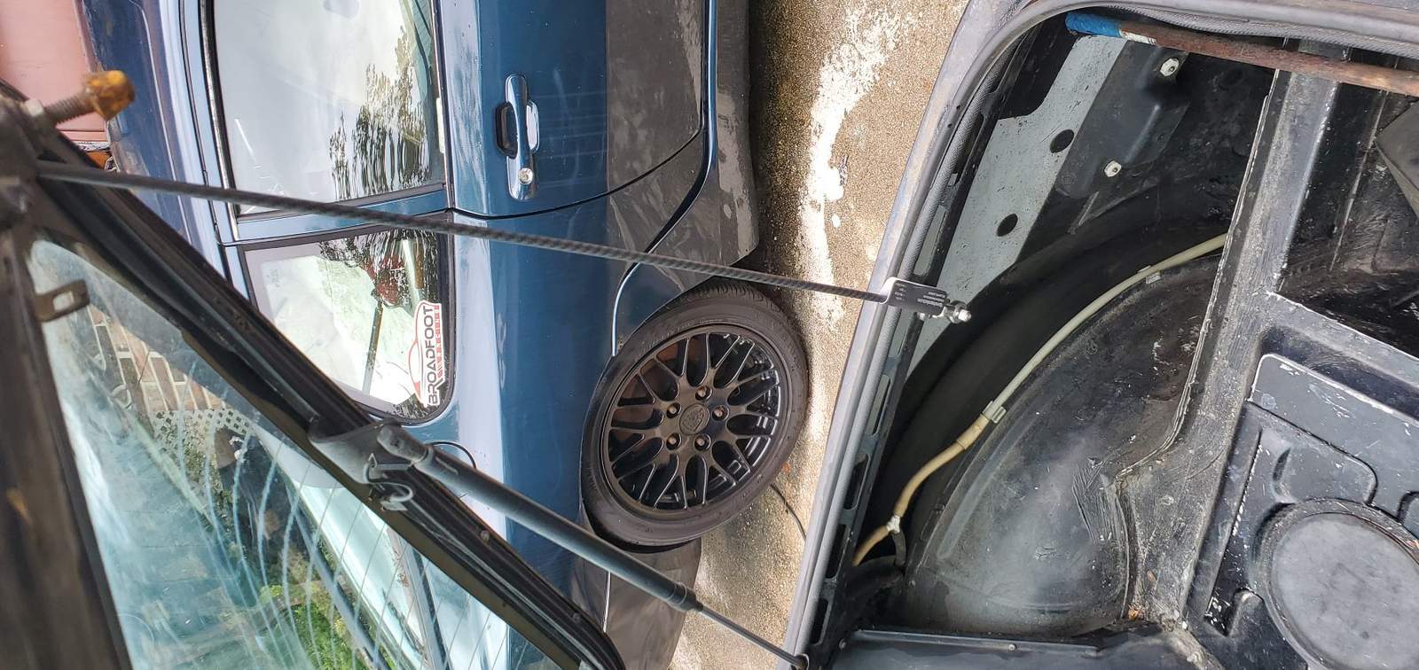

Interesting Fix to weak Hatch Shocks

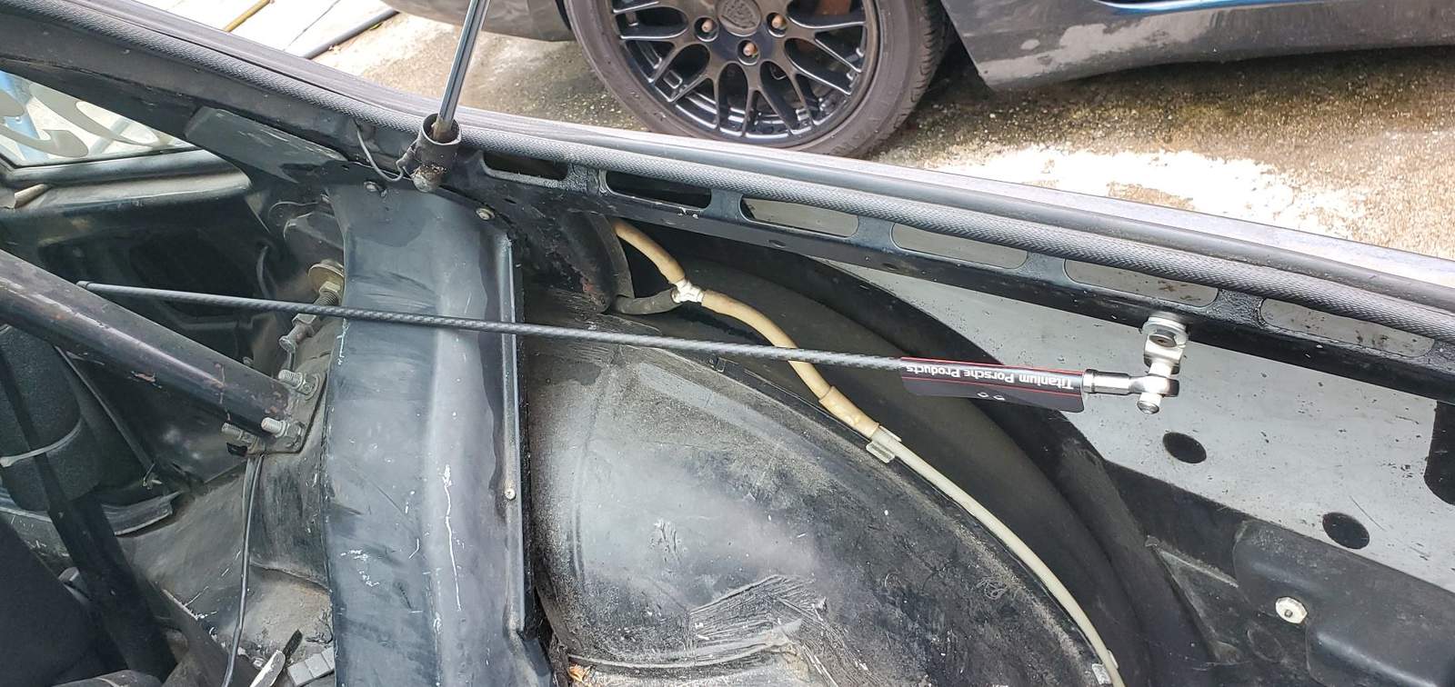

Like most of our cars, the hatch shocks are very tired and installing new ones tend to help the old hatches separate from the glass. Well, I decided to go old school with a prop.

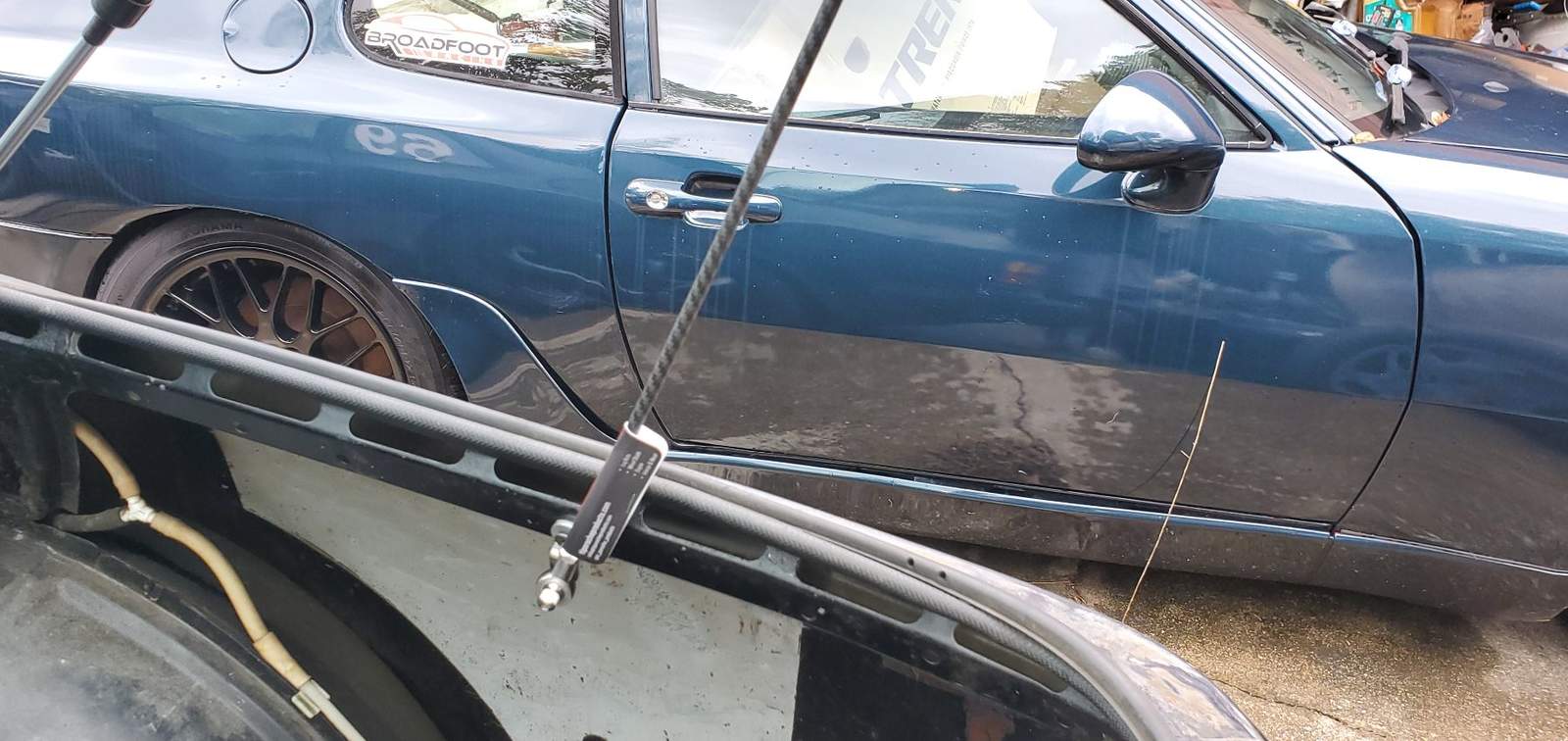

My cure was to install a carbon fiber hood prop for the rear hatch. So far I am very happy with this fix.

Slick alternative and works great on 911 trunk lids in the link.
Do you run two prop rods? I would think running only 1 would flex the frame unevenly and perhaps cause more stress than popping in two newer gas struts.
I considered a regular (wood) prop rod that I could center on the rear hatch to even the stress on the frame, but if its centered, its hard to get things in or out of the hatch

Good point, so far, no problem.

A single prop on one side would flex the rear glass hatch and may cause damages - the glass is to heavy and its frame many not HOLD it well.
