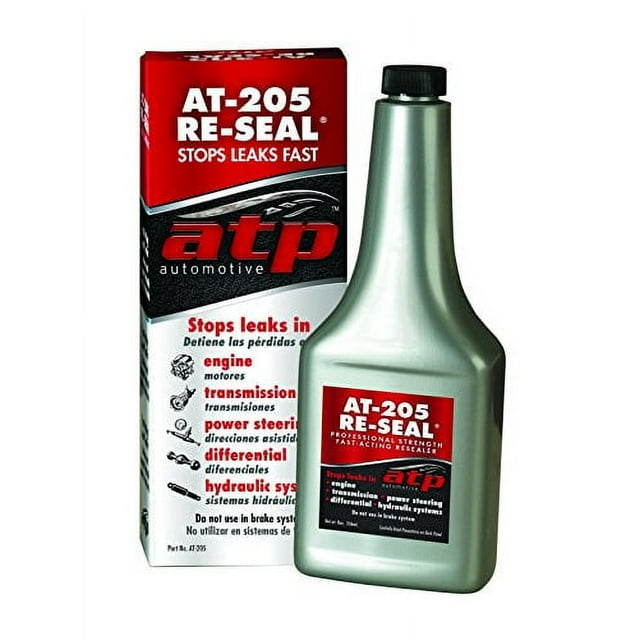

OP, if your gasket is dry, wipe it with AT-205 (re-seal), This chemical swells the rubber and makes it pliable. Works well on exterior door weatherstripping (vertical thin strip).
