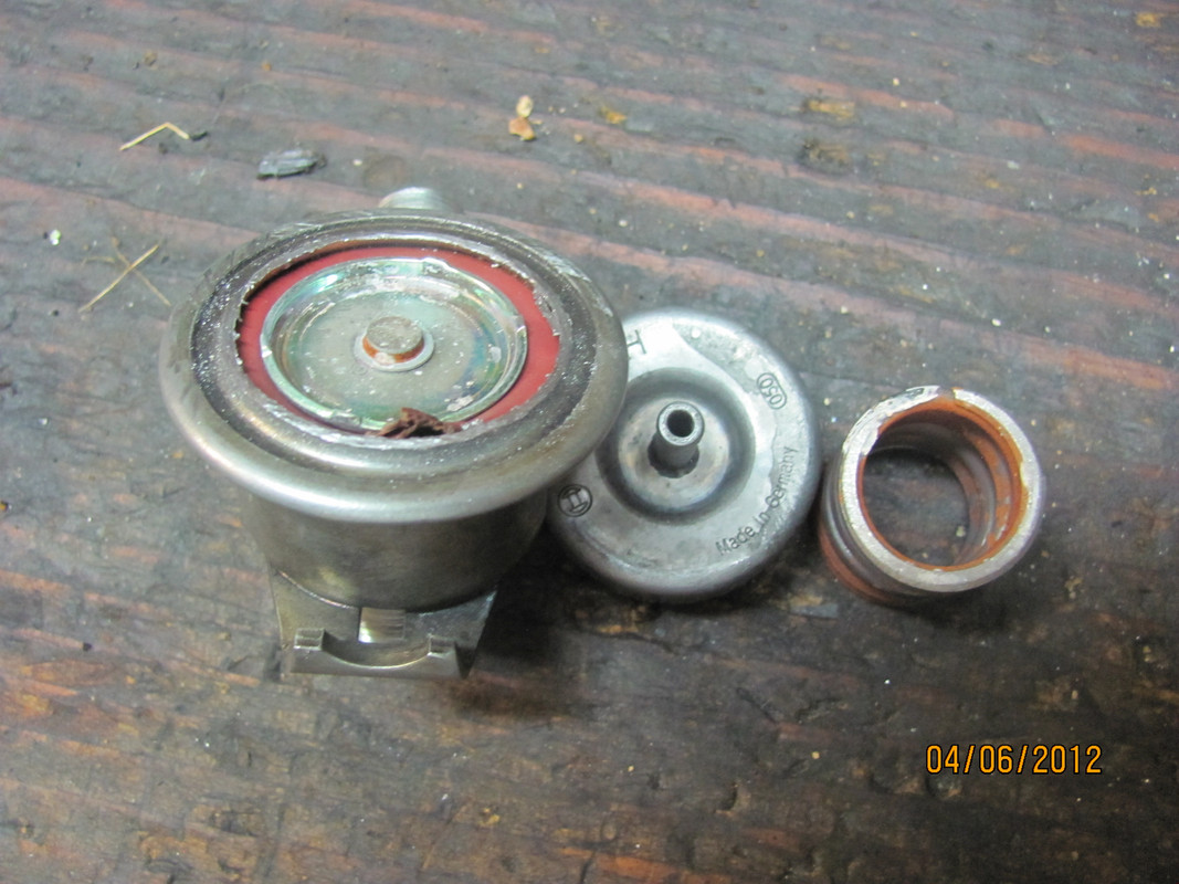

FPR could be leaking, a lot of that going around these days as they age out.
Of course look at the spark plugs for clues, check the FPR vacuum line for fuel, etc.
It's best to check these things right when the problem manifests.
People seem to have trouble diagnosing a leaking fuel pressure regulator, not finding obvious fuel in the vacuum line. It might only leak under vacuum when it's in the early stages. A good test might be to install a section of clear tubing or maybe a small fuel filter inline and see if you can see some fuel droplets or wetness appear in it.
When they really fail they will hose out a lot of fuel so it's not good to disconnect them and start the car without a plan to manage that fuel under the hood. You can disconnect the vacuum line to the FPR and attach a hose from the FPR to a container of some sort, that's a good test but be very careful of the potential of fuel spilling.

Nope. Clark's has some shortcomings. The issue is fuel leakage past the diaphragm into the vacuum system, the regulator might work more or less normally otherwise. You might see it fail to compensate for vacuum correctly. I've had this happen on my 928 and in the early stages it's just a poor start, rough idle, rich running. When it really starts leaking the cat converter overheats as it burns all that extra fuel.

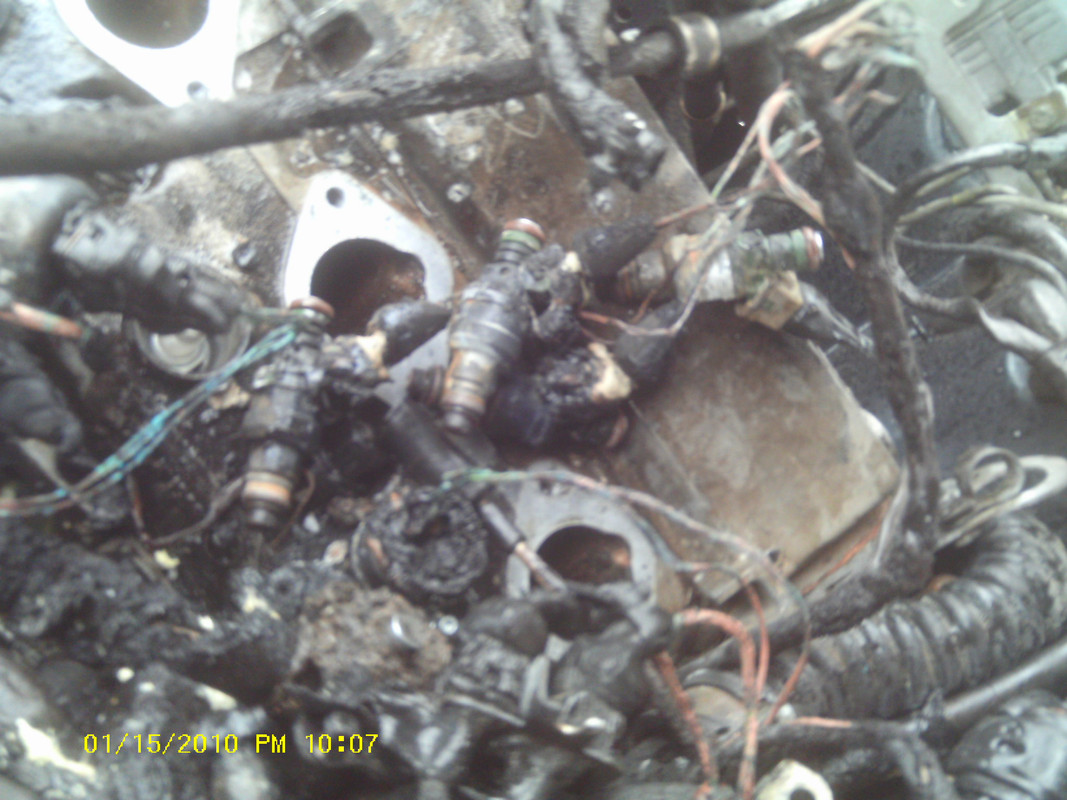

I diagnosed my fuel dampener diaphragm leak via an engine fire while on track with my Turbo car...
