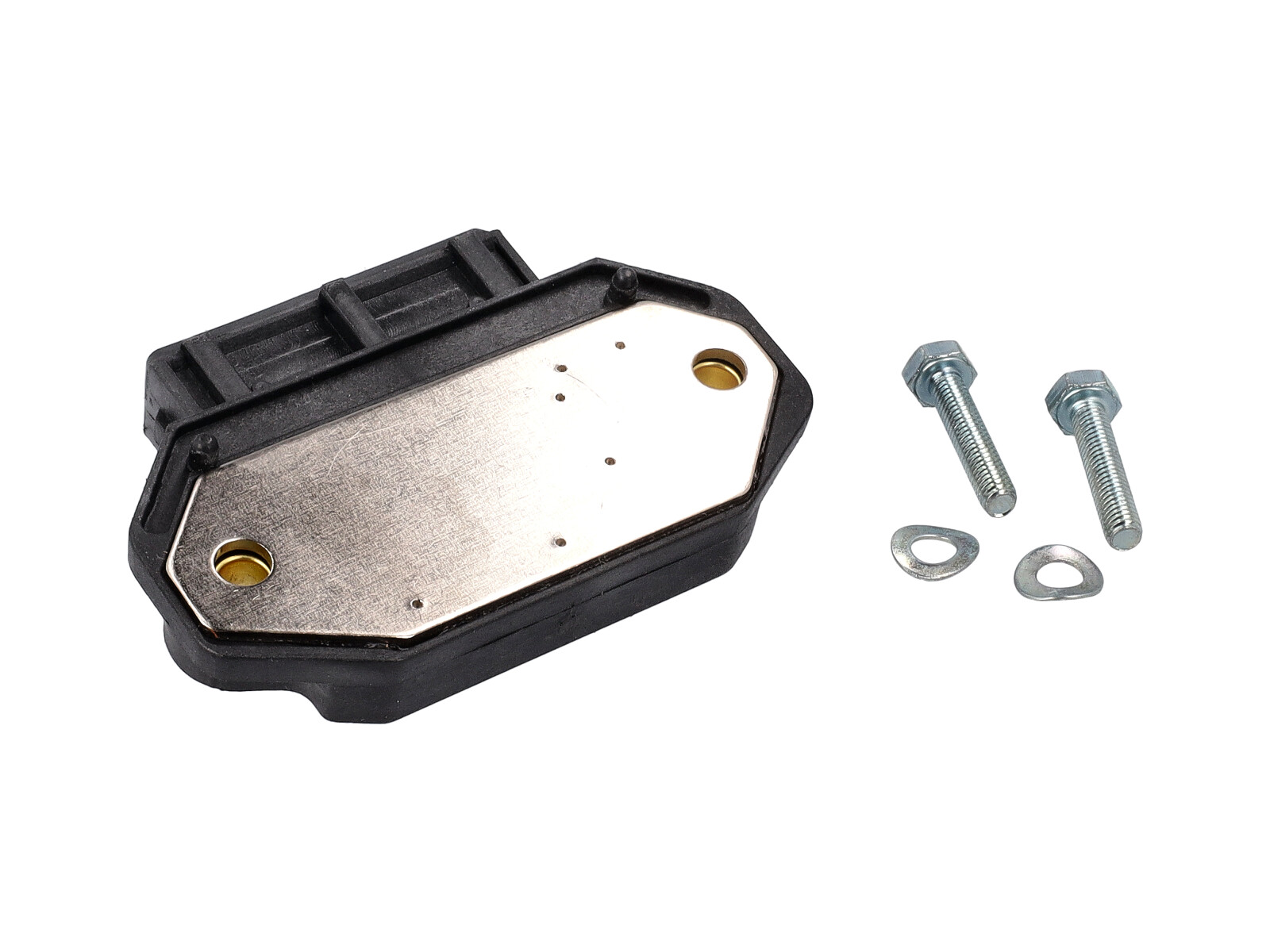

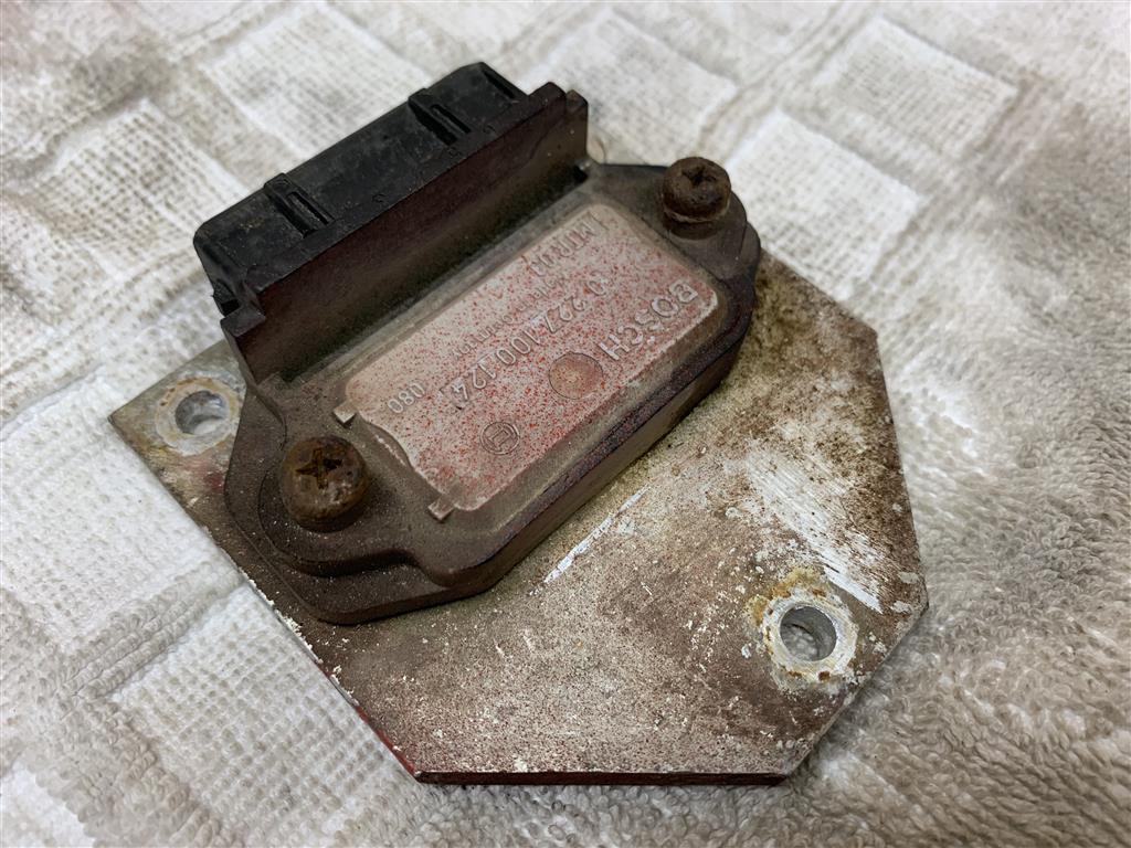

It seems to mention the transistor on the DME, but I wondered if this part was also involved, and from there Im a bit grey.
Its been my understanding that this component , which I believe is mounted near the driver side fender area is involved? Im not clear if it was perhaps not part of the design of this particular DME. ,
https://www.design911.com/uploads/products/1cc3fee9-d7f9-4456-a315-04528922c2a9/92860270601_3.jpg
im not sure if that link might get blocked, in case itgets blocked here is anothe rpic of the frontside of the thing. just as a visual reference.
https://www.douglasvalley.co.uk/images/20000/19533/fancybox_IMG_9521.JPG
I figured it was sort of a little amplifier, transistor basically and sits beteween the DME and the coil electrically. others can explain better about the imporance of it or if or why it exists and how to check it,
I just thought if this component failed it might add confusion or perhas be the culprit
I know in a volvo it has one too and it has some heat putty to transfer heat to the body so obviously it needed that for extra cooling of the component itelf.

That unit is a Bosche ignitor module and exactly the unit I wired in during my testing. It can indeed operate as an amplifier of sorts which is why I wired one in as the final step to confirm the DME had failed.
Although they are installed factory on the later 16v 944's. The earlier 8v motors did not have one. It can still be used (like I did) to absolutely confirm that no signal is coming out of the DME to trigger the coil.
