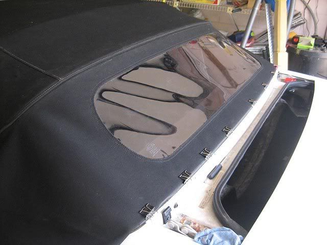

Where to go from here?
I have a semi plan, but I'd like to hear how others have done this.
I have the top part of the window piece glued and screwed to the bow. I'm not quite sure how to go about getting the bottom and sides glued to the bottom rail so it will be tight. I just have it clipped to the rail for now. Any suggestions would be helpful.
