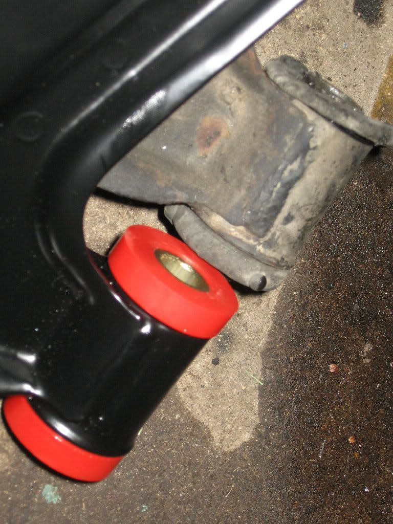

The steelies freshen up pretty well. . .
YES, I know the rear bush is backwards. . .flipped it before installing!

The red bushings in Rasta's pic are Prothane brand for a Mk1 VW. These are better quality than Weltmeister poly bushings, and at about $25 for a full set, you can't beat 'em.
I just put new steel A-arms, ball joints, and Prothane bushings on my 924S for a total of just under $100. The alignment afterward costs more than the parts, fer cryin' out loud.

FWIW, I also had mine seam welded. . .cheap insurance against those spot welds letting go.
