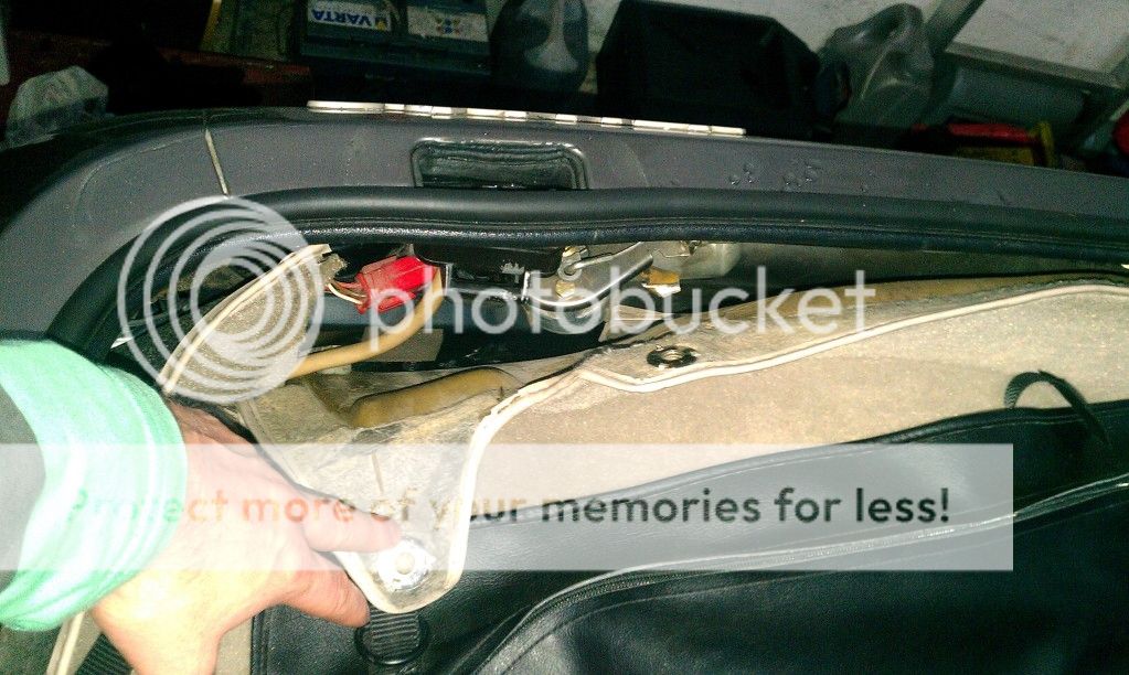

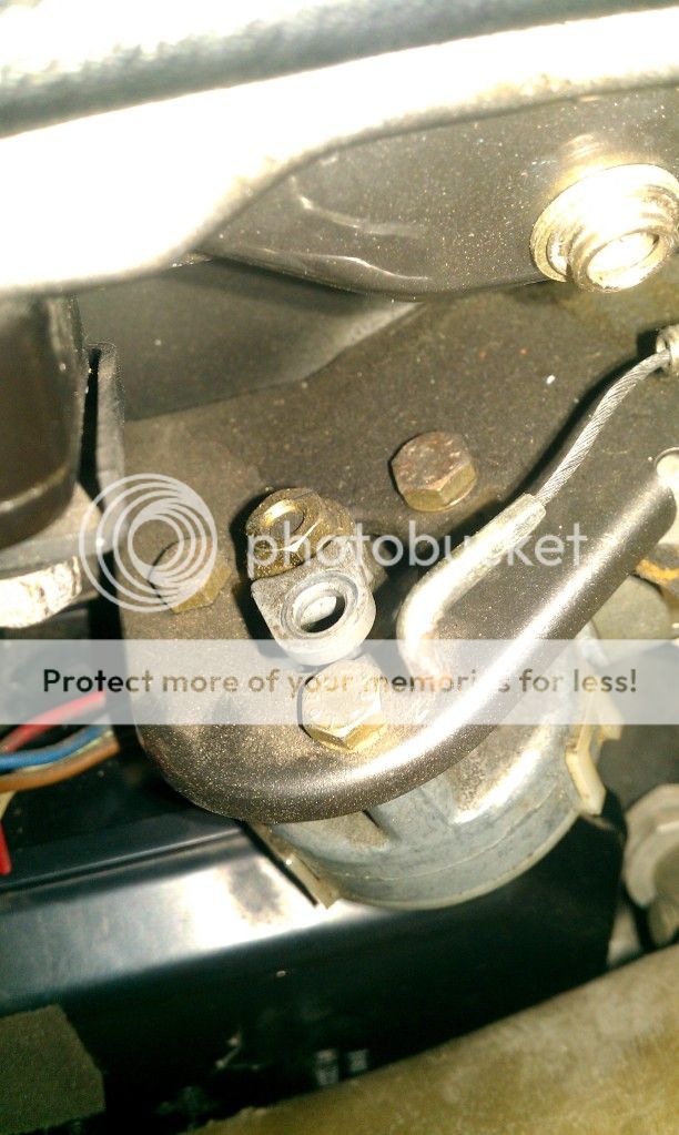

The electric opening of the rear hatch is not working on my 951 at the moment, due to the fact that the plastic clip which is supposed to attach the wire to the lever on the electric motor is missing. See the included pictures which shows what I am talking about. There should be a plastic clip inside the hole on the lever, to fasten the bent end on the wire. Does anyone know the correct name and/or part number so that I can see if the host or others have this part for sale?

993.531.563.00, about a dollar from here, probably available at your Porsche dealer in Norway.
Good luck, George Beuselinck
