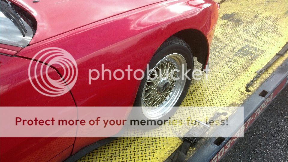

hey guys back in october my porsche's control arm broke on the highway. my porsche has been sittin in my driveway since, i start the car and let it run for about 30 min to 45 min everyweek and let it idle. i've noticed that everything i do that though the cars acting weird. Today i let the car run and i came out to it pased the red point on the coolent this has never happend, i turned on the fans and no heat came out. so i reved it slightly cand my heat level went down, i continued to do that intill the level was back to normal. all the sudden the rpms droped and smoke came from under the hood alot of it i shut off the car and opened the hood. all the coolent in the car was gone it dumped all over my driveway. i cant find where the hose exploded it came from the back of the engine near the firewall but i felt all the hoses and couldent find any tears ideas!!

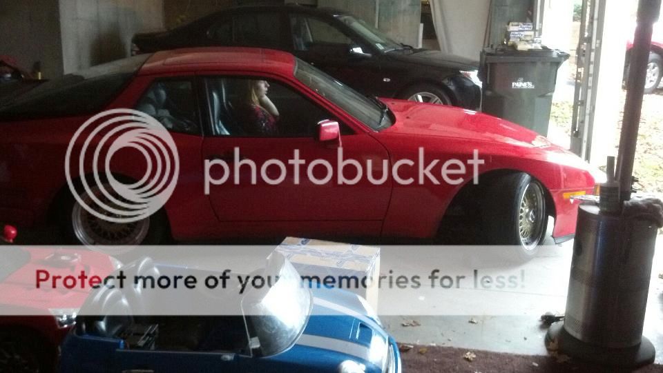

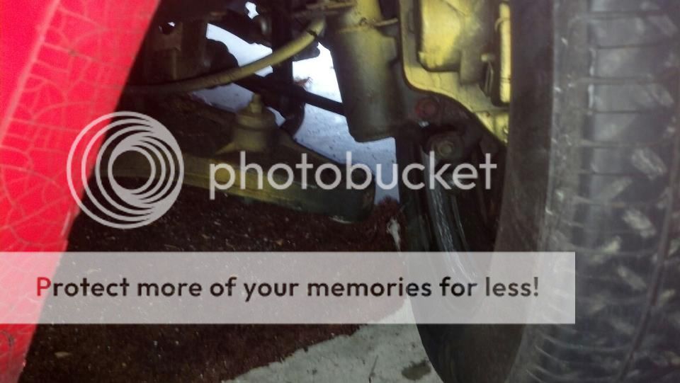

Ball joinf came completely out and the wheel dmacked back into the fender boeing it out, shredded the tire and cracked the wheel the alighnments off and the whole strut assembely came off... the only thibg that saved me from getying killed was the car was low enough where the tire tucked in completly

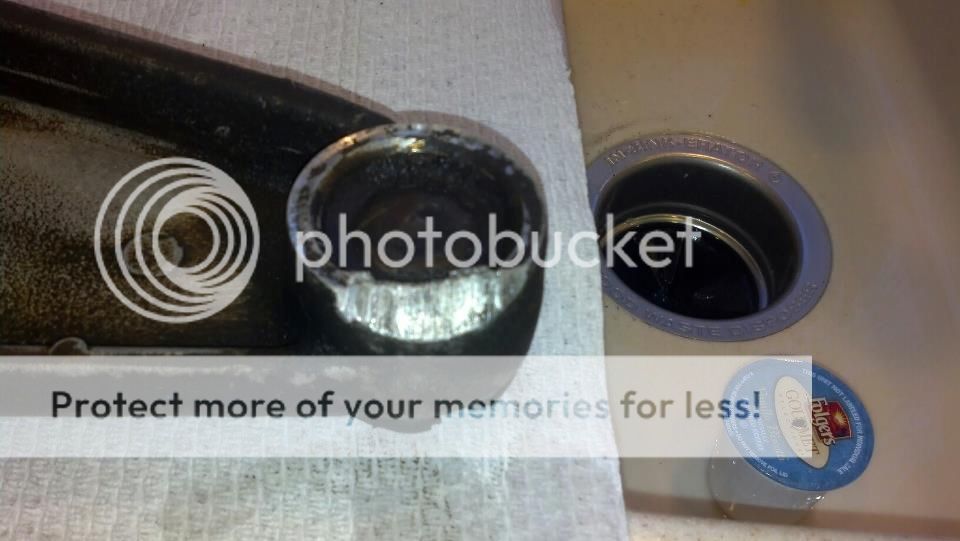

basic maintenance sorry but i have to stand up for myself the shop that Claimed to have replaced the ball Joints with the rebuild kit just put all new parts in the arm but used the same ball i was told it looked fine by a mechanic i didn't neglect this car
then this
all dirty from it dragging on the ground

On some cars if you lower them too much you can lever the ball joints apart while driving.
