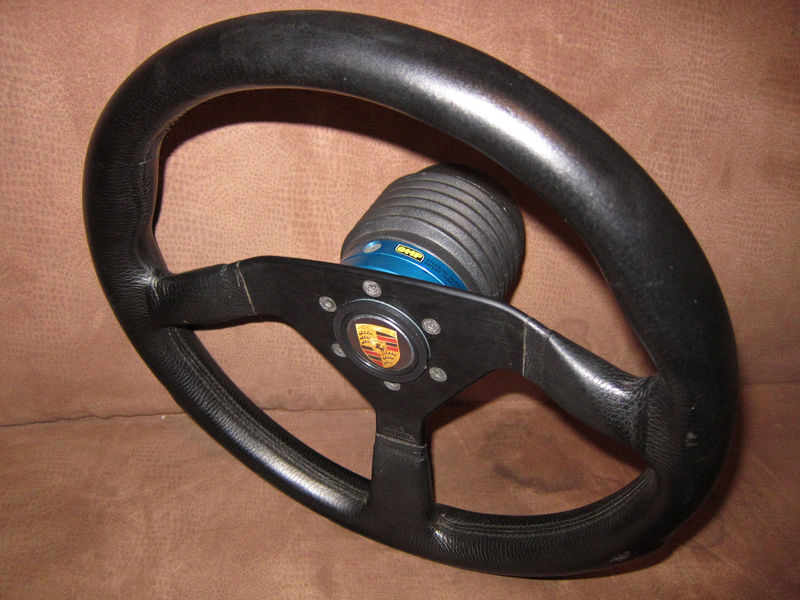

Just got my Momo hub but when I test fitted the gap between it and the steering column surprised me, anyone else? Couple of pics of the stock wheel and the new Momo in place. Thanks Ralph

Like this:
That's an OMP adjustable wheel spacer, the blue part in between the wheel itself and the adaptor, BTW.

Thanks guys, but the rubber accordion fits perfectly down to the part that sits on the steering column, here's a pic. Check the gap, it's twice the size of the OEM wheel. I do have the correct hub, 8010 and I spoke with Momo who's thought was that Porsche used different steering columns and that could be the issue. I going to call the retailer today for their thoughts on what I should do. The car was manufactured 1/84. Ralph

Good morning Roger, I sold the car about 2 years ago but if I remember correctly after installing the hub and tightening everything down the gap did reduce somewhat but not nearly as small as the original and I didn't notice the gap after a short time. Ralph

Yeah, something's not right there- I have the same 8010 hub installed in my 84, and there's very little gap there:
