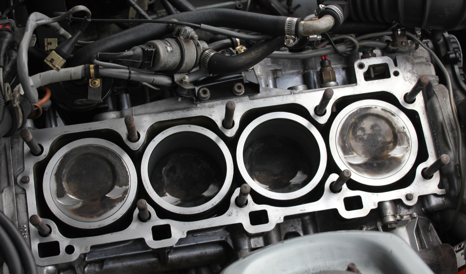

Just take the head off and find out. Here's what I found in mine..... US spec.
But seriously.... maybe a boroscope through the spark plug hole.

I rebuilt the top end in May of 2011 but I did not modify the pistons so I guess that idea is out the door. Thanks for the note.
Yep, you need those Euro pistons (on the right), a DME and cat delete to get to Euro spec.
Here are my 10.6cr Chinamen before they were coated and installed:
