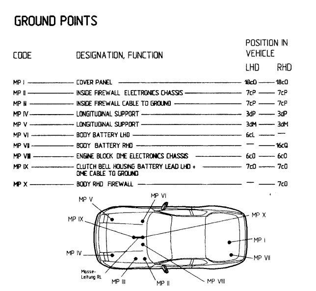

I recently pulled my instrument cluster to check my weak temperature/gas combo gauge. I barely get a reading on the temperature gauge and the gas needle would start of stuck. I cleaned all the points on the three male connectors. Reinstalled everything and test drive it. Gas gauged stayed stuck until I drove it for 15 minutes or so. Then it would be fine after that for the rest of the day. I could tap on the instrument glass and it would start working. If it sits over night, same problem. Now it is staying stuck until your warm it up, stop and cut the engine off. If you turn the key, the gas needle pops right up. Weird. Temp gauge working better now though. All other gauges work fine. Any ideas?

Sorry to be brief but it sure sounds like some ground is in need of cleaning.

Anyone got a map or schematic showing where all the grounds are located?

Old 11-06-2014, 08:35 AM
uvachief
uvachief's Avatar
Join Date: Aug 2010
Location: Moseley, VA
Posts: 605
Send a message via Yahoo to uvachief
You da man!
Sincerely,
uvachief
1986 944 NA Red 5SPD
Old 11-06-2014, 09:21 AM
uvachief
uvachief's Avatar
Join Date: Aug 2010
Posts: 605
Ground points needed to be cleaned. In addition, the female wiring connector tended to work its way loose form the male cluster connectors over time. That was causing most of my problems. The fuel gauge still sticks so I haven't cleaned something correctly.
